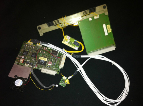

Posted: Sun Mar 18, 2012 1:57 pm    Post subject:
I think that you removed IBCL link module, not port3.
In fact, IBCL Link board occupies the slot of port3.
In the picture below you can see the SEMU elements
Contrast modulation is ultra rare module and it can work alone. Leave it!

Posted: Sun Mar 18, 2012 5:12 pm    Post subject:
I am pretty sure I removed the port 3 since I already have two sitting in a box here Smile I will doublecheck to be 100% sure.
Looks like the pictures you does not correspond to the cards I have.

Posted: Sun Mar 18, 2012 7:45 pm    Post subject:
Well, at least the PJ works perfectly without the port 3 card (I am pretty sure it is the right card, it was connected to the port3 connector on the switcher card and looks exactly and have the same partnr as the other port 3 cards I have).
I removed the two connections from the RGB output card that is marked "to soft edge module" and soldered the jumpers back on. The PJ works perfectly Smile
In the controller box, are both card 1 and card 2 in this picture to be removed? (I guess it is hard to leave card 1 after 2 has been removed Smile )
So the fan is only for semu?
I also "found" (have never really thought about it before) the contrast modulation in the menus of the barco. I guess that is what the card that was attached to the output card was all about. Dont know what it really does but I am sure I can read up on that.
BarcoGraphics 1208s/2 and BarcoGraphics 1209s/E

Posted: Sun Mar 18, 2012 8:29 pm    Post subject:
The card 1 is Iris interface. The card 2 is SEMU interface (with his little fan).
You must remove both cards.
Then Insert card 1 in the only one slot present.
Domenico (Barco fan!)

Posted: Tue Mar 20, 2012 7:06 am    Post subject:
Thanks a lot for your help!
I removed both the SEMU card and the IRIS card (never used IRIS anyway).
Removing the SEMU was a good idea, I am pretty sure that the noise was greatly reduced! First start of the PJ and I could hear a difference. Must have been the small fan on high rpm resonating in the controller box that is now removed.
