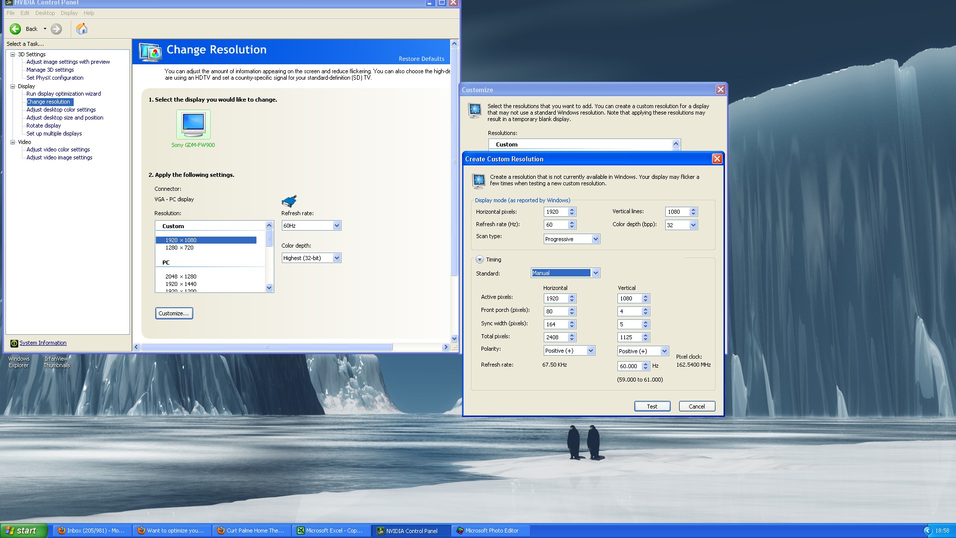

I have attatched my current timings for all too see, Scott set these up for me as I did not get it.

Current timings to run 1080p

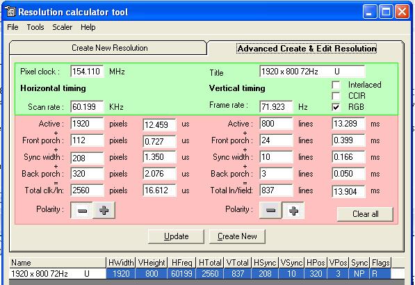

for 2.4 set it at 800 active lines. The picture should look too tall, you then have to squeeze it down in the PJ if there is enough adjustment for vertical size. I am not sure how a PC uses the desktop lines but it might be better to use around 837. I'm a VP guy and not a PC user so the interface is different.

Thanks, is the resolution calculator tool you have there a part of the VP or is there somewhere I can get it? , also is there a calculation for bandwidth in all these figures?

Posted: Mon Feb 27, 2012 2:28 pm    Post subject:
It is a tool from the TV-One web site for use in their VP's
http://tvone.CRMdesk.com/image.aspx?mode=file&id=385
The Pixel clock is the bandwidth. The Ampro should handle my settings even though it says 100mhz I think its way under rated.

Are your settings compatable with this? My settings are in the jpeg at the top of the thread.
