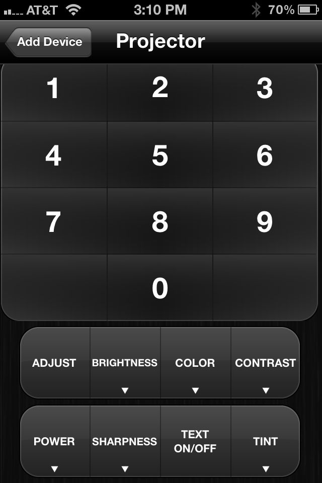

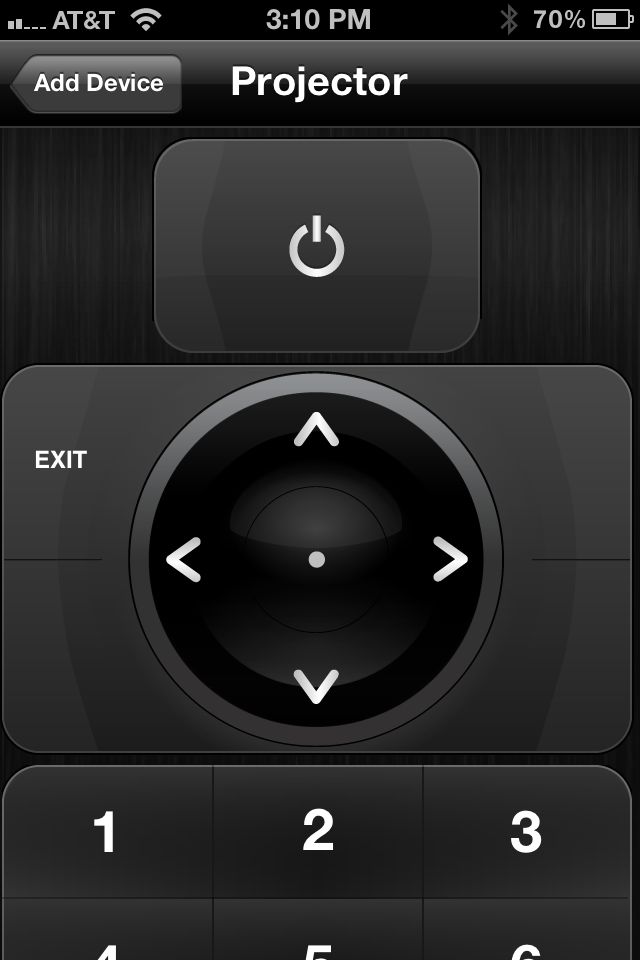

Posted: Sun Apr 01, 2012 8:21 pm    Post subject:
Tom.W wrote:
See this post
https://www.curtpalme.com/forum_archived/viewtopic.php@t=30201.html
Thanks!
I finally found some time to sit down and and get the setup done.
Turns out that the best info for the RS232 commands was in the Runco 992 Ultra manual, which is more or less the same as my Barco 808s.
Using the Global Cache iTach TCP/IP to Serial (RS232), which is just a sweet product, I can now fully control the Barco via my iPad/iPhone. I have created every Remote Control command so that I have the full Barco remote (only using address 0 for simplicity, that is).
Am finally able to pull the remaining IR sensors out of my setup as everything is IP/Serial controlled using discrete commands Very Happy
The iPhone makes a perfect remote for adjusting convergence, etc. as the serial commands work much better than using an IR remote.
If there is anyone else planning to use a RoomieRemote, I'll be more than happy to upload the file.
I have included a couple screenshots of the device remote.
Thanks again to point me in the right direction...
Wolfman
