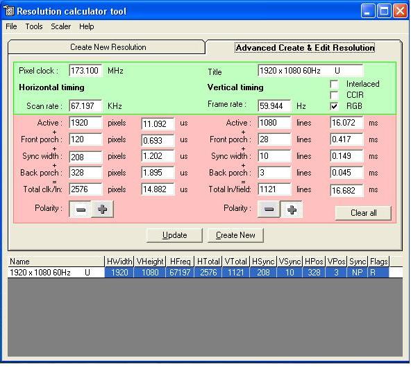

Posted: Thu Feb 02, 2012 2:17 am    Post subject:
Here is a screen shot of 1080p@60
First you enter the basic pixels 1920x1080 at 60 hz 16x9 aspect and select create, the click on the
advanced tab to show what my screen shot has.
 Filesize:  67.12 KB
 Viewed:  15127 Time(s)

Posted: Thu Feb 02, 2012 4:39 am    Post subject:
I just put those settings up so JB could get an idea of what the numbers would do in the program , and to show him what the sync timings would be in micro seconds(μς).
JB start with what the Lumagen gives you for 1080p@60 output. the input should be set to 1090p@24 or @60 depending on what your player is set to. Then add VTOT . What is the VTOT default of the lumagen?

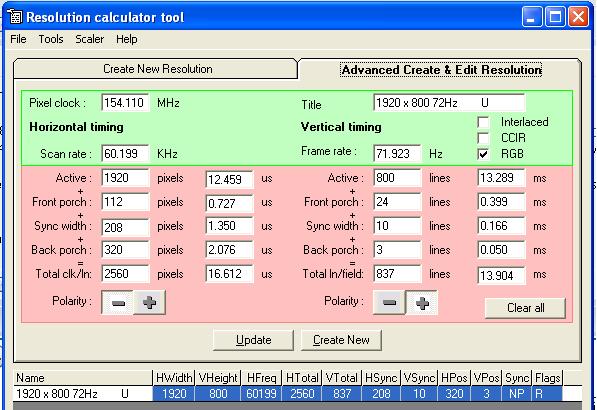

Posted: Thu Feb 02, 2012 3:49 pm    Post subject:
Here is a quick set up for 800p@72 from the res editor. I can't remember if I used this or not. One thing JB, is with the lumagen it had a glitch that if you had the Onscreen menu up while video was on at high bandwidths the image would judder. just close the Onscreen menu
and the imgage should move smoothly. if you dont hit save and you power off and back on it goes to last saved memory.
Dennis you dont have a HDQ do you?
Now the image here will be too tall, so you have to go into the shrink function to get the proper
aspect.
