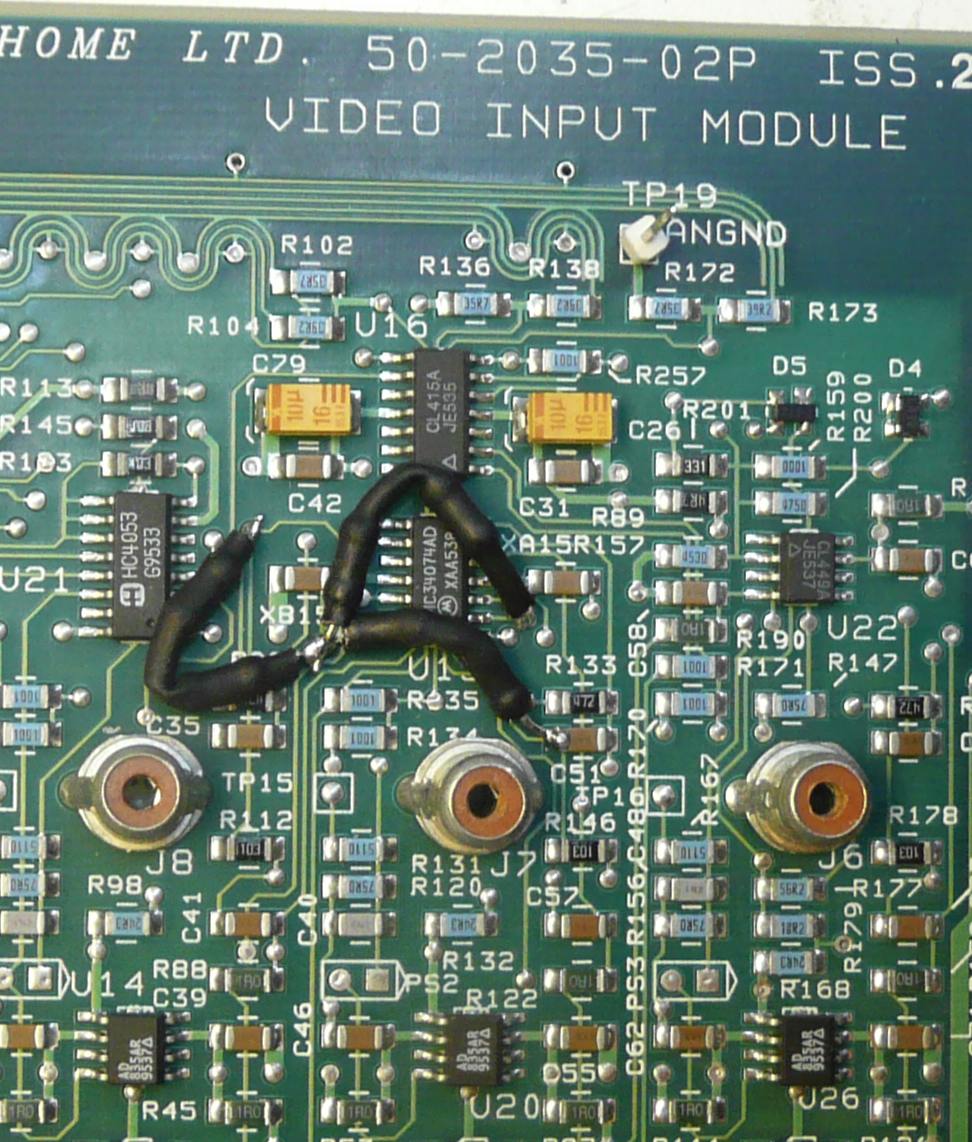

Hi Everybody,
I did the following mod to my VIM:
http://www.curtpalme.com/docs/ElectrohomeMarqueeTechnicalBulletin_LineFix.pdf
Now I have the impression that after this mod the blacklevels have to be adjusted and the image has much less contrast.
I did a color correction (G2 and drive settings with internal signals) and i looks better but still duller that before the modification.
The faint vertical line near the right side of the image has dissappeared.
Could this be just imagination (I forgot to look at the image before doing the mod) or did I do something wrong.
I've double checked everything and it should be OK I've put the resistors on the component side instead but I guess that shouldn't matter. I've used a 1M and 520K 1/4watt resistor in series instead of the 1/8 watt 1M5 that was recommended
I've put a picture of my mod.
What is your opinion about that.
Regards,
Ron
 Filesize:  198.12 KB
 Viewed:  14225 Time(s)
Posted: Thu Jan 12, 2012 9:13 pm    Post subject:
First off it looks a bird pooped on your board Laughing
I'm joking, my only thought is your running resistors directly over some delicate chips which might not like having a resistor sitting on top of them. If the factory engineers instructed to put the resistors on the back-side there's almost certainly a reason for it.
Other than that that this modification raises Brightness level significantly, that's normal. Where on a stock marquee you might run Brightness 40 to 45 after the mod I found good Black levels come in at 10 to 20. I also took down the Brightness in my BD player a little as well. IMO, the shadow detail and full fade to black on my marquee are very good.

Posted: Thu Jan 12, 2012 9:23 pm    Post subject:
Thanks Draganm,
In the mod one of the resistors is actually on the component side.
I put everything on the component side because there is the ground backplane that's very close to the soldering points and I din't want to make a short to ground.
I also have the impression that the image was less sharp but in order to do the mod I had to move the projector back and forward (it's on a table with wheels until i mount it on the ceiling) and the focus could be different. It could also be blooming since the brightness is no higher
Thanks for your answer.
Regards,
Ron.

Posted: Wed Apr 25, 2012 8:24 pm    Post subject:
Hi everybody,
I'm still puzzled with this mod.
(I've done a noise reducing mod on the LVPS that was very successful in the meantime to reassure myself that I'm capable of doing something right.)
I now have a fresh look at it and I wonder if this mod is for my board. My board is labeled "50-2035-02P iss.2" but in the doc they talk about Video input modules 02-270335-02P through 05P
I have also changed the "bird pooped construction" in something according to the tech field bulletin but that doesn't give any improvement.
I have adjusted the G2 and DRIVE settings with internal signals but have not checked that with an external test pattern.
I have the feeling that I'm heavily overdrive the tubes.
When I start up the cold projector the image is actually good but it becomes a bit less sharp and a bit washed out after a few minutes.
What I also noticed is that when i view a scene with a black background and white text that when the text disappears i can still see this text but now in black blacker than the black background. Even when another white text appears I can still see this first text in black overwritten by the new white text. This black text stays there for at least 8 to 10 seconds. Is this normal remanence of the tube or is it because i drive it too hard?
I hope I made myself clear.
I'm really considering undoing the mod and live with the faint line.
Can anybody comment on this?
