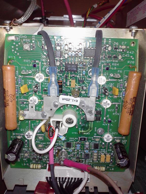

Hey Nash, it was set to autoranging AC/DC but it was locking onto a DC voltage - I forced it to DC and got the same result.
I also switched out the HVPS for a known good one and got the same result. Boards / modules switched so far: VIM, LVPS, HVPS.
I did take a look at my cheap-o radioshack DMM and it looks like it's only rated for 500v, so it may not be able to handle the full G2 voltage - however, it looks like it's reading a valid voltage, the reading fluctuates slightly, etc. It doesn't look like an error, but I guess it could have a really weird way of handling overvoltage.
Just to get a reality check I've attached a picture of the VNB and circled how I'm taking the reading.
Thanks guys!

Posted: Sun Dec 04, 2011 9:37 pm    Post subject:
I wonder if your going into Spotkill mode, disconnect one VNB at a time and turn the set on after each removal and replace, so we can count out a bad VNB. Pull the VNB plug at the mother board or right from the VNB( black umbilical)
