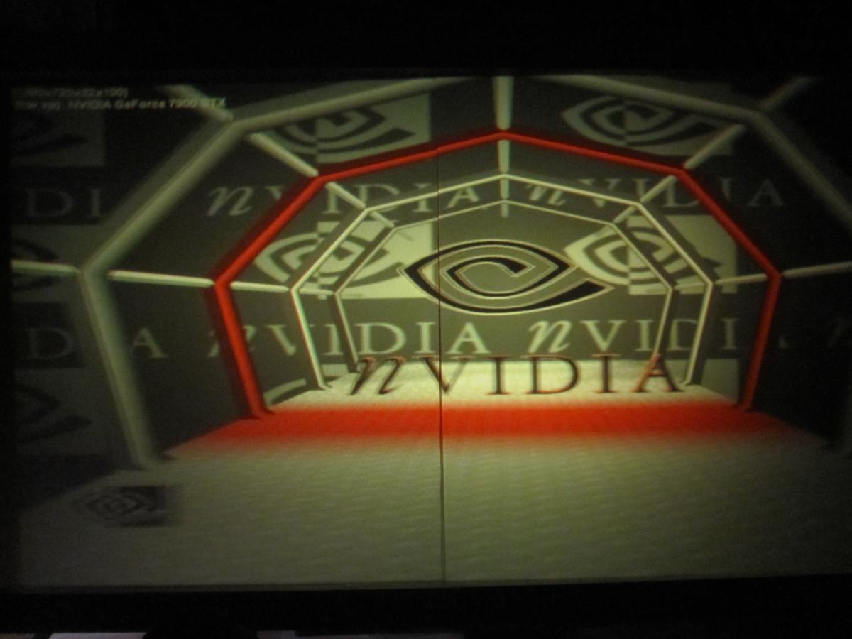

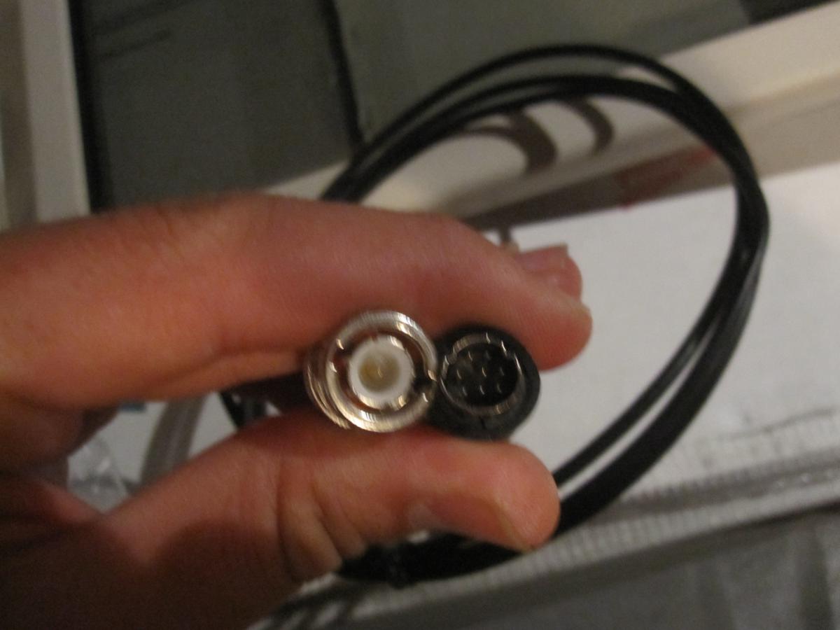

Hello,
as you know, there are two ways for passive 3d (non active non shuttering "sun" glasses - like in cinemas):
- using two projectors and polarization filters in front of the projector
- using a z-screen in front of the projector (like cinemas do)
I planned to do the first solution in the future, so I am way behind in building my curved high gain silver screen - because as you know - you need a screen that keeps the light polarization. So it should be a silver like screen, that should be curved because of hotspotting, or you use a rear projection screen that has this specific feature.

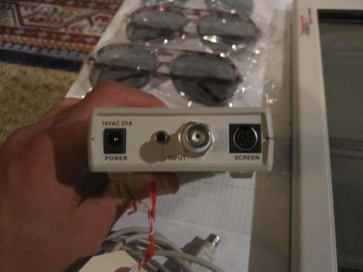

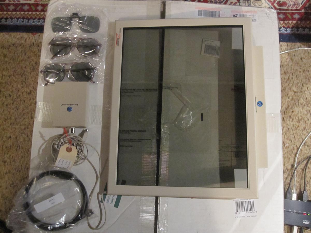

But I now got these Z-Screens for CRT monitors:
http://www.mfb-geo.com/spip.php?rubrique83
These tools are rare, and I was looking for them quite some time.

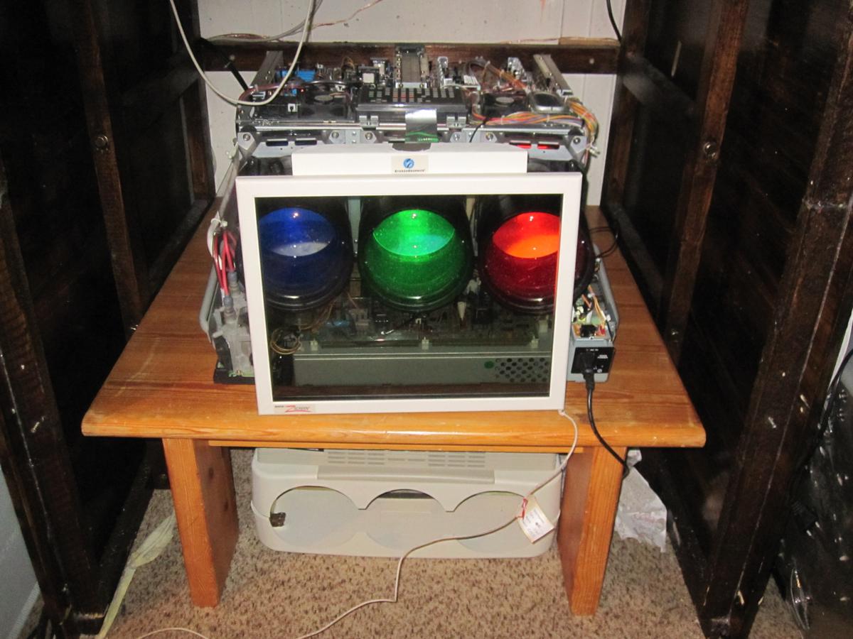

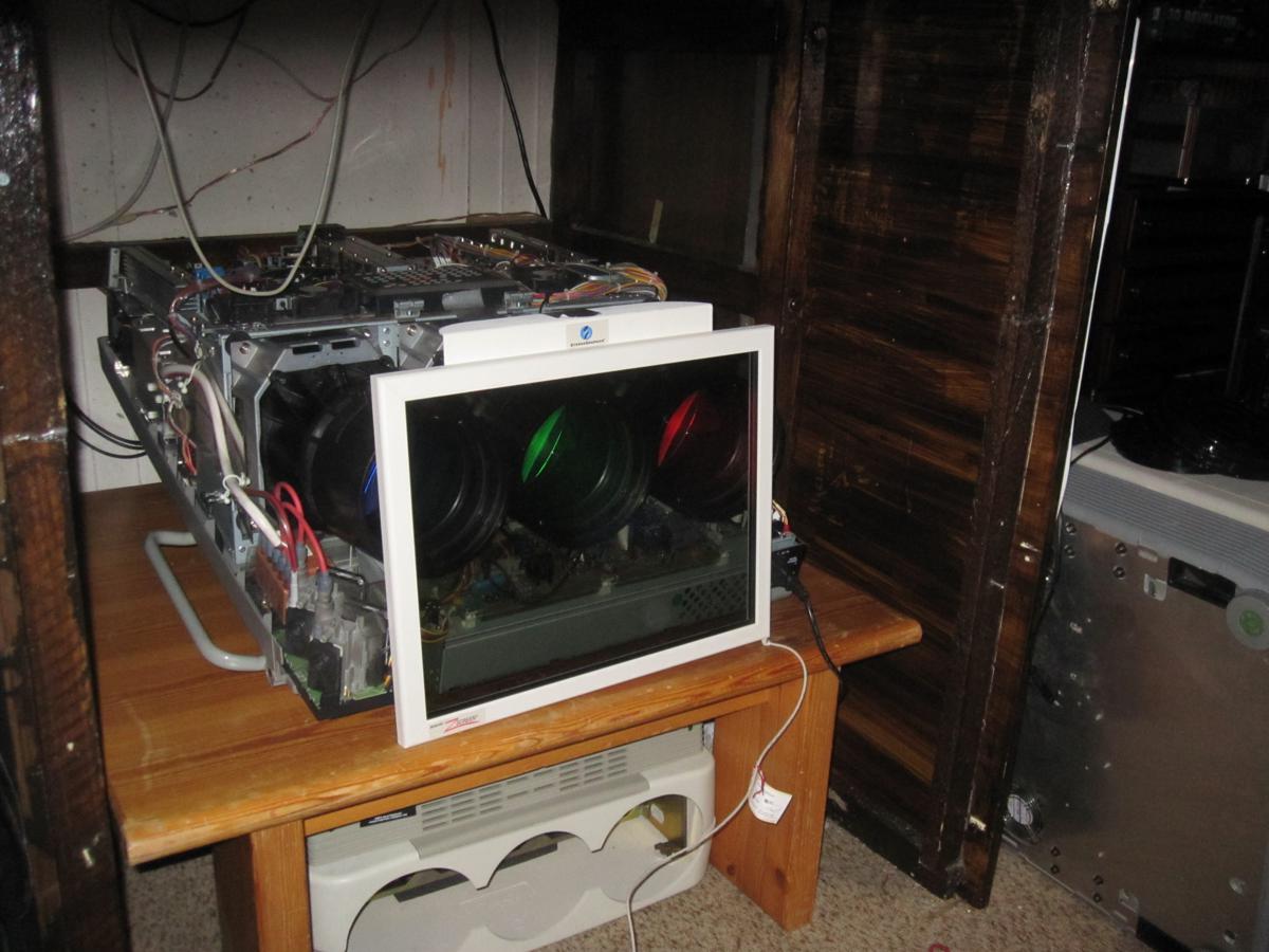

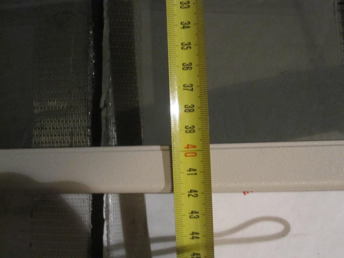

As my silver screen is a distant dream, I did build a reaprojection screen for testing the Z-Screen with a 1272. For 7" AC an 8" LC machines one Z-Screen is fine. With 8" AC or 9" you should use two Z-Screens.
I did test these screens with crt monitors, and as the Barco pdf shows, they have a little more ghosting and are a bit dimmer than shutter glasses solutions. But I was able to use also the cinema glasses from Avatar....

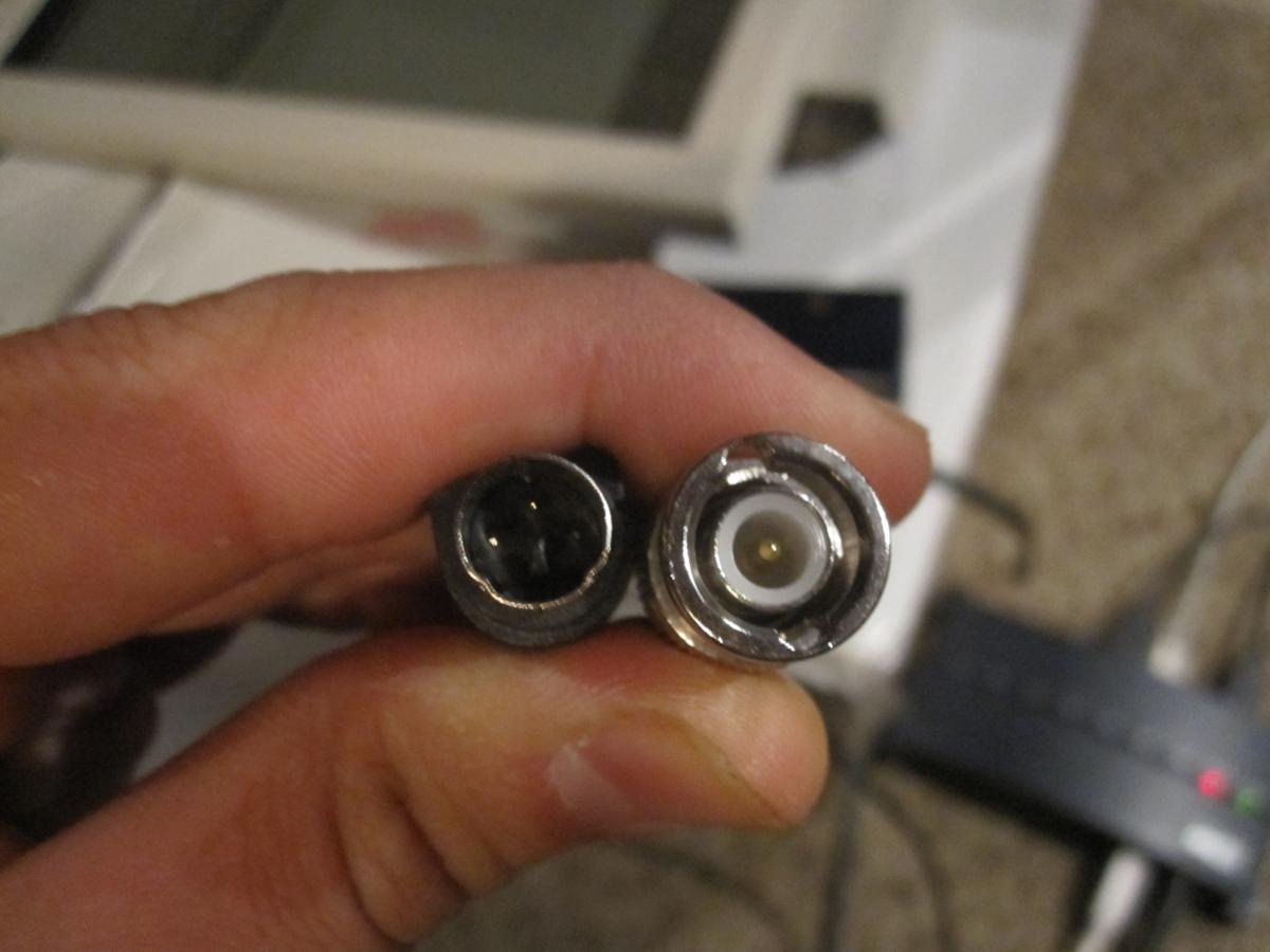

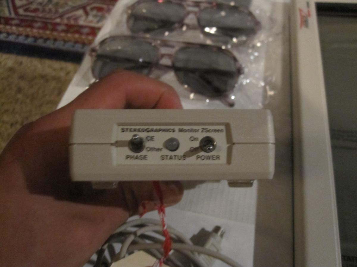

The screens accept the standard 3d sync signal. But, my reaprojection screen does not keep the polarization, so I will get me a different material or build the curvesd silver screen an update the process here.
I guess these screens should also work with digitals that are not polarized like LCDs are (DLP?)...?
The seller has some of them left on the shelves. They cost a fraction of their high 4 digits price in the ninties - and I will ask him if I can post his email here for contact. I will also post that report on AVS and mtbs, but I will give you here an advance for the Z-screens, if the seller clears his shelves.
... I keept my writing short, as I will update my findings when I found a screen material taht keeps polarization.
Regards
Marc

So, I now have permission and details from the seller of these Z-Screens:
mark_frnka@comcast.net
You can write to him, but in the subject you should mention Z-Screens. He is selling medical equipment, so I guess these screens were intended to use in 3D applications in an hospital or clinic, but never were used. He has a couple of these Z-Screens, and they are all brand new an in the original package. They come with cables and controller plus three passive glasses. But you can use the cinema glasses, so I guess these screens a circular polarized. I fear that day when I will have to buy circular polarized sheets for a dual projector setup with CRTs ($$$). Considering this, the condition of the screens, the insane prices some companys (that have probably misses digital revolution) ask for these screens, and that they are rare like henīs teeth - 150$ for one screen is a steal. I am sure the seller will give you two for 250$. He is located in the US, but he is shipping worldwide. He did pack two screens for me in one original package, and shipped it to Germany for 63$.
Ragards
Marc
