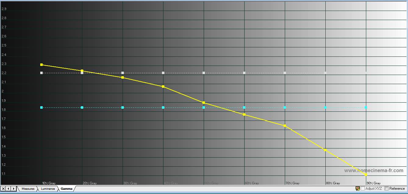

Hi guys. I have Eye One Display 2, Color Hcfr and Pioneer Kuro. No matter what I do I can't flatten my gamma curve which dives significantly at about 50 IRE and goes off the scale. I must have spent 20 hours trying to get it to improve but nothing really helps. Any suggestions on what's causing this? Thanx

Posted: Sun Aug 28, 2011 1:11 pm    Post subject:
Show all your curves, not just gamma - or upload the ColorHCFR file. Something else may be telling. For example, sometimes you run out of a certain colour drive on the high end that causes odd issues and the only way to fix it is to lower contrast. Not saying that's your issue, just saying that by showing more information things sometimes get more obvious.

Posted: Sun Aug 28, 2011 2:42 pm    Post subject: Re: Gamma curve dives - help needed!!
With a digital set, the signal processing internally can be made to do about anything. Thus an unnatural gamma curve can be created in the digital domain that is not adjustable by the normal ways...
That being said, I have calibrated tons of Kuro panels and I never have had an instance where I could not get a sweet gamma off the panel. Things to mess with on this panel include the brightness and contrast controls, the gamma setting its self, and also the user mode preset (PURE, CINEMA, USER, DYNAMIC, or whatever your panel has). Chances are that you need to start out with the correct preset to get a good gamma response. Usually on a Kuro you should choose PURE if it is available, if not than in this order of availability; natural, movie, user.
My guess is that you may be on a preset such as DYNAMIC which is designed to rocket the gamma curve like this to exaggerate dark areas and give the impression of better black levels while highlighting bright areas giving the impression of more contrast...

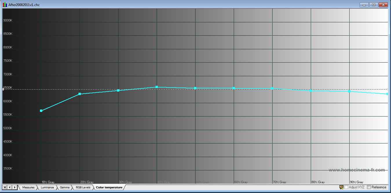

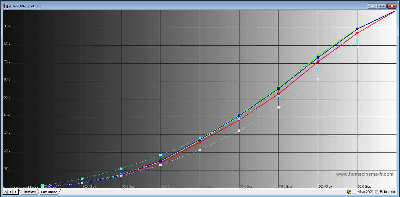

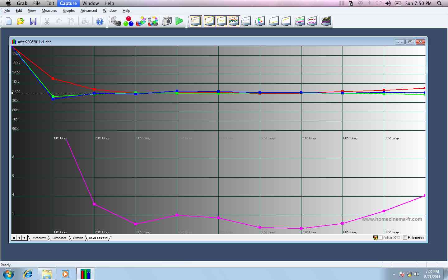

Hi guys. I've attached the graphs as suggested. Note I have gamma on the Pioneer set to 2, Black level=off, mode=user.
Thanks for your help

Posted: Thu Dec 29, 2011 1:33 am    Post subject:
Hi Goro - Im not sure if it is too late to help you now, but I had a similar problem with my Samsung plasma, and for the longest time I couldnt figure out what was causing it.
I modified everything from the backlight intensity, to the gamma adjustment, brightness, contrast - nothing seemed to work.
I seemed to have a heavily downward sloping gamma and a luminance graph that severely humped between 30-80IRE.
If you have a 'dynamic contrast' option (as I did) turn it off! After doing this I recalibrated and my gamma was near ruler flat at 2.2, and my luminance tracked beautifully.
Worth a shot anyway!

Hey Damo
Thanks for the suggestion. I've checked all the settings and switched them all 'off'. I'm still working on it but the only way I can get it to improve is turn the contrast right down (from 42 to 24) which helps a lot but the picture seems flat. I'm not sure on what else to try...
Spwill
Joined: 12 Jan 2012
Posts: 1
Posted: Thu Jan 12, 2012 3:27 am    Post subject:
