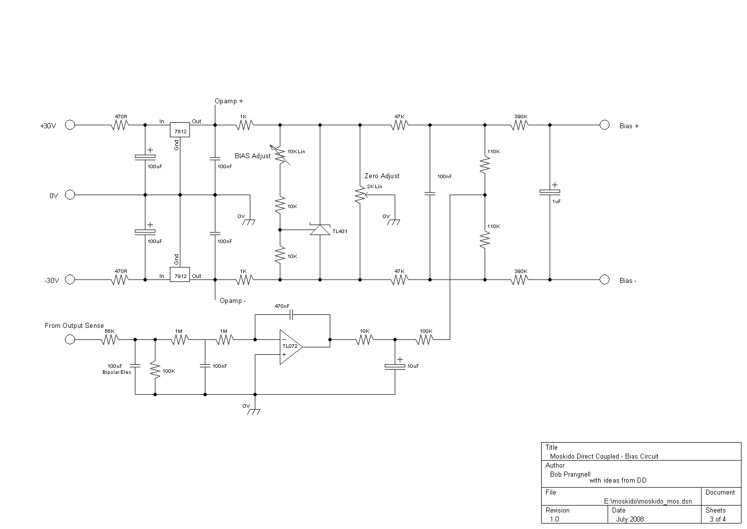

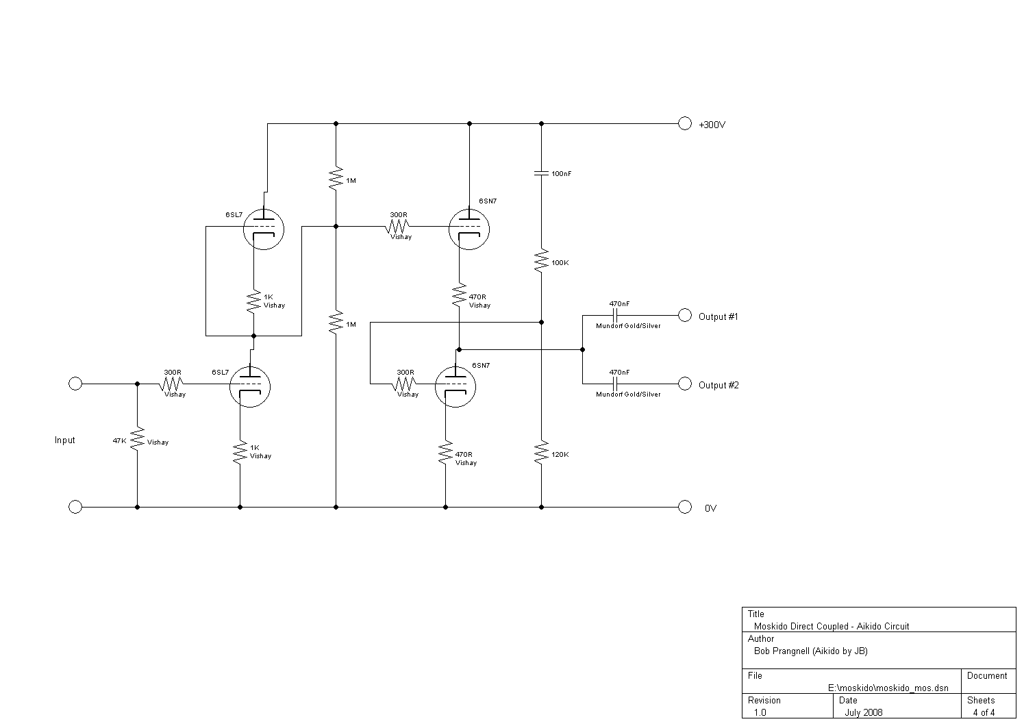

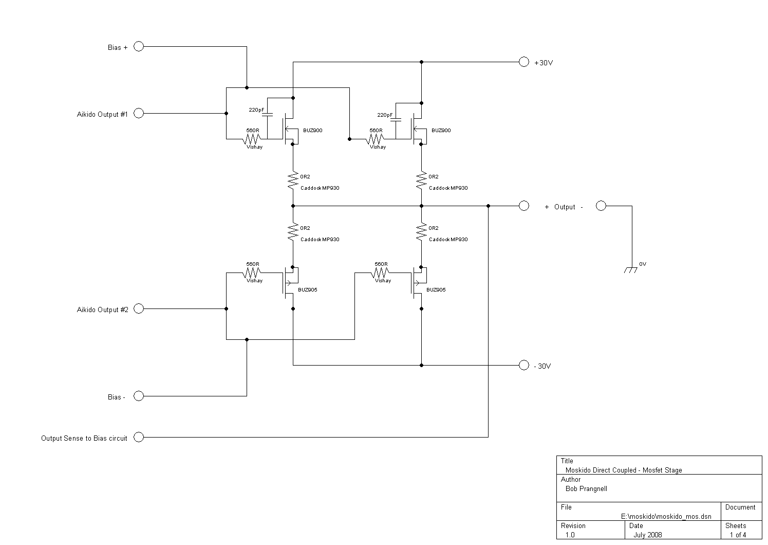

it is from john broskie from the glassware website.
this is called the moskido, it has the aikido driver stage with the 6sn7 and 6sl7 tubes and a mosfet output stage with an added autobias which does wonders.
this amp is sounding amazing but i warn you that after you build an amp like this you will need to upgrade all the lesser parts.
i am hearing details now from records i never heard.

oh i might add that you will need huge heatsinks cause this amps produces a lot of heat!!!
go for 0.3C/W or better.
and add fans, i will do this later as the entire case gets too hot for the touch.

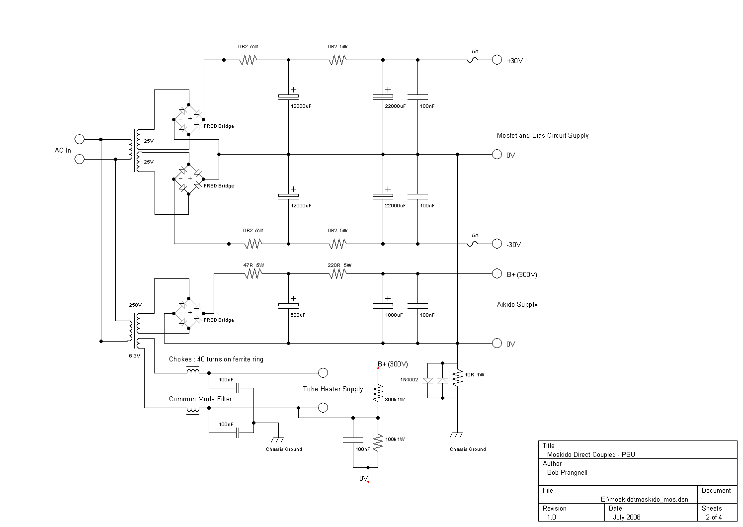

you could opt for bigger toroids if you think this is needed.
i used 300va per channel plus a 70va for the aikido stage.... and a small transformer for 2 softstarts Smile.
if you like a lot of headroom go for 500va per channel or more but be sure to use a softstart circuit for those big toroids.
i also used screw type ps caps, i got these on ebay and they are fantastic, my voltage is at 29.72vdc on both channels, not a mv the difference.
i used a rcrcrcrcc configuration.
8*4700uf and 2*14000uf.
the 4700 measure 5200uf so that is about 70.000uf per channel and that really is enough when using screw type caps.
http://www.farnell.com/datasheets/526225.pdf
http://www.vishay.com/docs/42065/36dy.pdf
i used a big piece of solid copper to connect the ps caps, this way you have a nice signal ground too.
bob prangell compared this amp to a f4 pass labs and it was simply no match he said.
if you like vinyl get the phono pre from john broskie too and a line stage pre and maybe a step up transformer when using a low output mc cartridge, this will be far better then using the pre out from a reveiver, the aikido design is quite unique and so is its sound.
it`s on par with a kraudio transducer amp and that says a lot.
last thing, the schematic says to use hexfred bridges but a regular rectifier bridge works quite well i can assure you.

if i were to rebuild this amp i would use a heatsink like this so i could bias the fets a little higher. (currently 185mv across the source resistors)
http://nl.farnell.com/fischer-elektronik/la-17-200-24v/heat-sink-fan-cooled-24v/dp/1222532
for the source resistors i used 5*1ohm/1watt thick film smd resistors in parallel.
this is every bit as good as an expensive caddock resistor but much cheaper.
