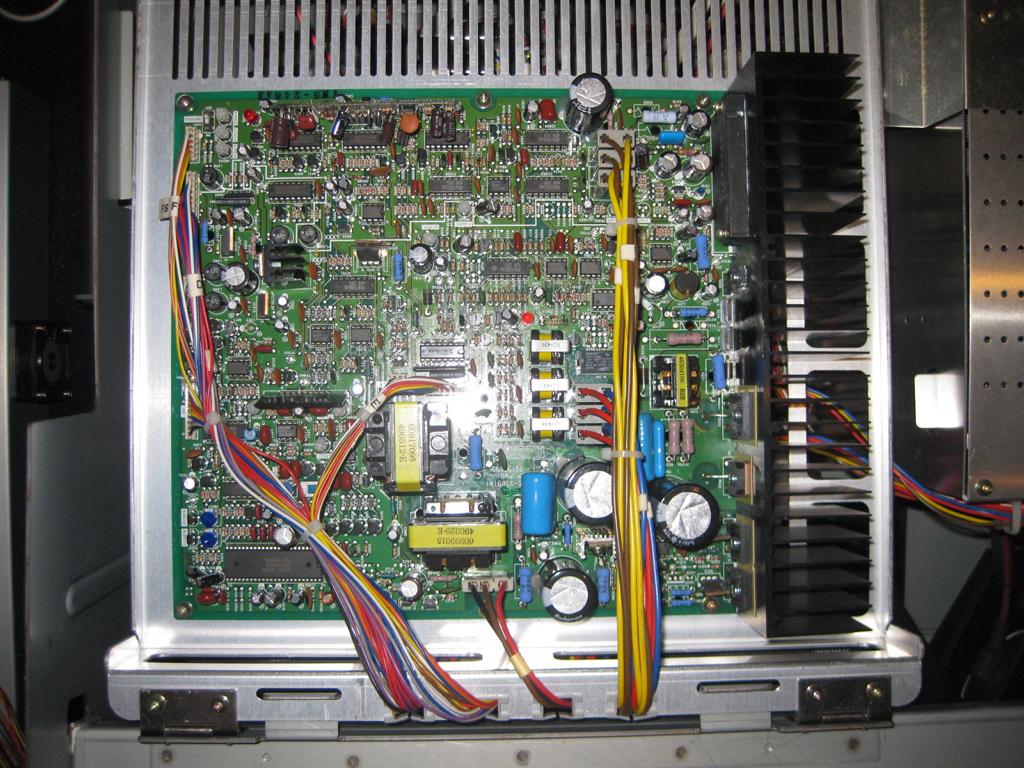

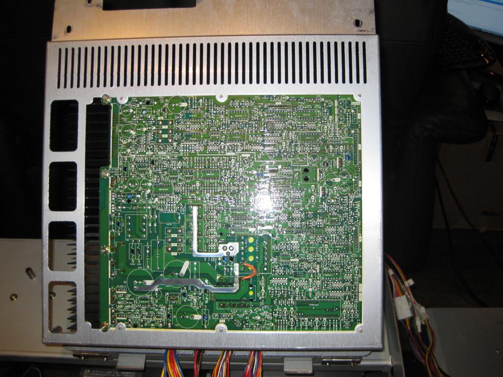

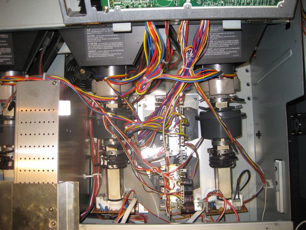

anybody knows if this is the original 10PG Deflection board or allready the plus?

tell me the part number of the deflection board and I will check

thanks Kai, PWC-3709 (A) on both machines. Could this be the part number?
Did a quick set up with a green tube only, Silicone on both ring sets was broken and raster position and astig not correct. Will have to look up again how to correctly set astig. Blops are round and centered bit focus is not yet on PGxtra level. Confused

The real part number of the def board is like 72137091 or ...94 (in Plus) or ...96 (in extra) plus the ink-stamp number. By the look of it yours is ending with ..91 which is the plain PG def board

Searching for numbers with a 9* endinding I found DEF PWB 72137093. The ink stamp is IN5-246AJ.

here are 2 different PG9000 deflection boards I have on file:
Deflection Board DEF PWB PWC-3709(A) (1) 72137092 inkstamp: 1E7-43YAJ (2) 72137091 inkstamp: 1E7-132AG4
by the looks of it, the PG9000 uses deflection boards ending in 91, 92 or 93
