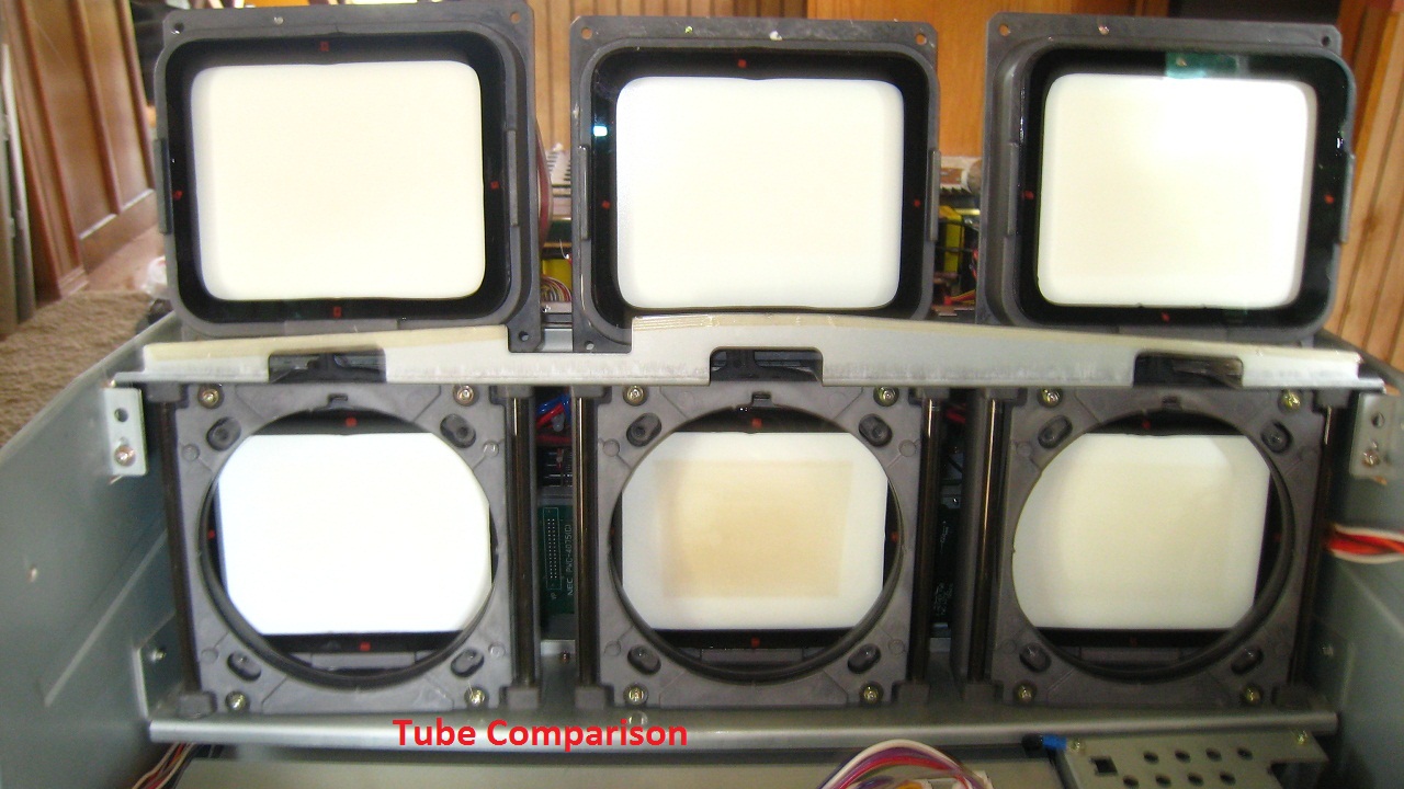

Thanks to Greg I have finally got new tubes for the XG1100 (new to me that is Smile )!!
They are fully installed and ready for testing, will do that in the morning when Im not so worn out Smile
For now, heres some pics Mr. Green

are you sure you didn`t put the old worn red back in?
Jeremy112
Joined: 28 Sep 2006
Posts: 2649
Location: Fond du Lac, WI
Posted: Fri Jul 08, 2011 2:45 am    Post subject:
on NECs its backwards, your actually looking at (from left to right) Red Green Blue. The "new" blue tube has wear thats pretty close to what my old blue tube had, but my old blue tube has screen burn from the xbox 360 dashboard, plus the new blue tube has a larger wear pattern on the phosphor.
So to answer your question, Im 100% sure Smile Razz

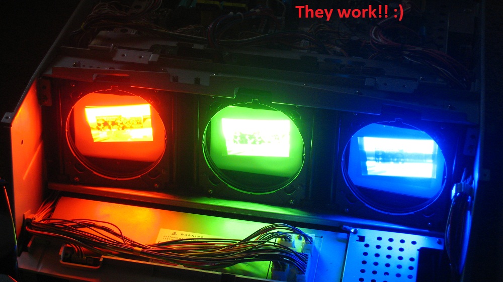

Heres the new tubes working! Mr. Green
Now I just need to get the Yolks all straightened out and start astigmation and so forth. Talk about fun Mr. Green !!!

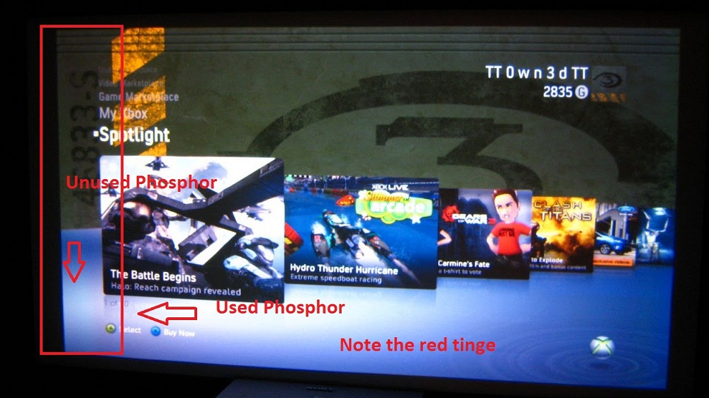

Also heres a pic from when I first bought the XG and set it up, it shows the wear on the tubes (on screen). The picture isn't great so its a bit hard to point out, so I put nice colorful arrows and text on the image Smile
EDIT: I should note that it was a very quick setup, thats why the convergence does not look so good, and if I remember correctly the edge focus and astig needed some work too

Congrats on the new tubes! You worked pretty fast getting those puppies installed.
Great to hear about bleeding the tubes and the blue tube for sure. It is by far the oldest out of the three tubes. Some day you may be able to find a new(er) blue tube without much wear. I had my projector so close to such a large screen that I could actually see about a 2" line on the right side of wear from the blue. I didn't want to make the image any smaller at the risk of ruining the brand new green and newer red tube.
Either way...you at least have a backup blue now with about as much wear. They should last you through that green and red.
