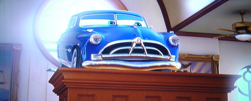

the next pic is color calibrated by eye Wink.
