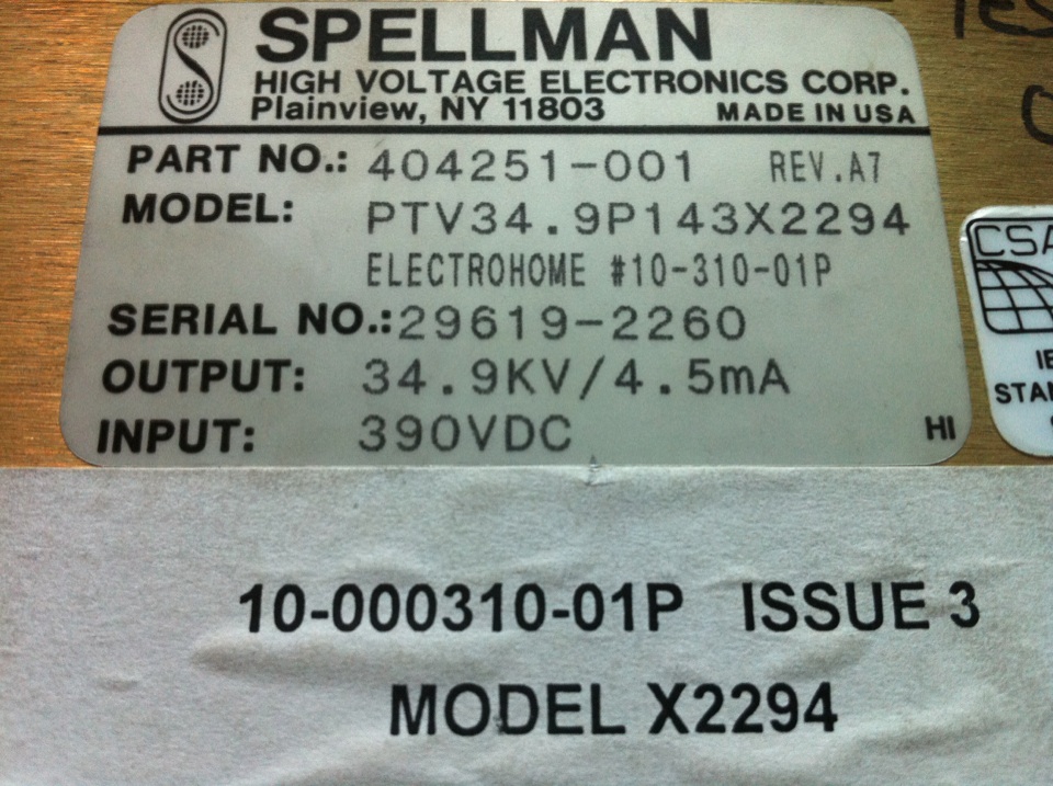

3. Part number as per attachment
HVPS PART NUMBER

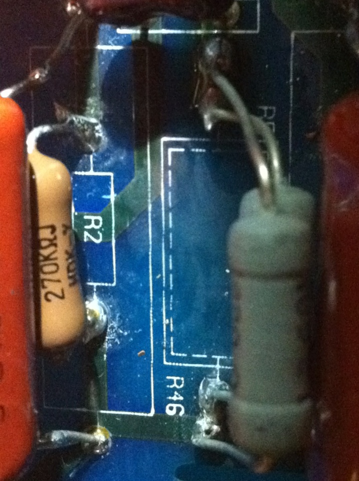

I'm sorry about the confusion. I just verified that the resistors that POP is R2 & R6. Instead of using 270k, i used 270 ohm and both of them POP. Physically, all other capacitors looks fine.

Ok, R2 is suppose to be 47 ohm. Do you want to recheck? I need you to be very specific.

You beat me to it ! Wink Yes R94 is 270k.

Guys,
Very interesting as my board shows R2 and not R94
Refer to photo attached.
However, does it matter? I have actually changed both to the correct value (270k) but why the image is still shaking.
HVPS below C3 is actually R2 and not R94
