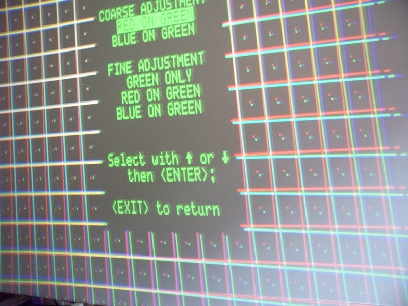

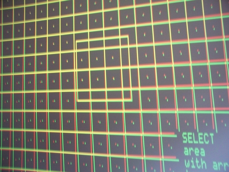

Hi again. It did it again. This time though, instead of just the general convergence shifting, all sorts of other things seemed to reset as well... the keystone, seagull, skew, bow, etc. I think things did reset to 50. In this round, the center was sort of ok, but the corners and sides were botched. I posted some pics. Not sure what to take a video of as it just happens when the machine is turned on. It still seems ok when I switch sources once it's up and running an re-converged.

Posted: Mon Jun 13, 2011 2:27 pm    Post subject:
Now check to see if all convergence values reset to 50. I don't think so. I'd suggest the controller board is bad.

I've been looking through the 808 tips section. By controller board, so you mean the vertical board with the red and blue height controls and V shifts? I believe the my 808 does have an iris... the little camera on the front. A few months ago, I went through the issue that I had turned on the auto converge thing and it was driving me nuts. That was resloved though (by realizing that was what was going on and turning it off) and it hadn't been a problem for some time. I should also note that all the blanking and the green raster (along with the others) and the horizontal shift and any number of other things seems to go whacky or reset as well.

Posted: Tue Jun 14, 2011 12:35 pm    Post subject:
By presence of the camera and the menu showed in the pictures, you have a BG808s
You can try to change step by step the boards in the convergence tray.
Convergence output board first (R762519), then convergence driver (R762518 newer version).
I don't remember if in the Iris menu there's a automatic run option, with timer or other, check this.
