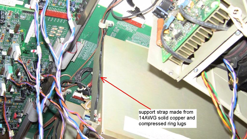

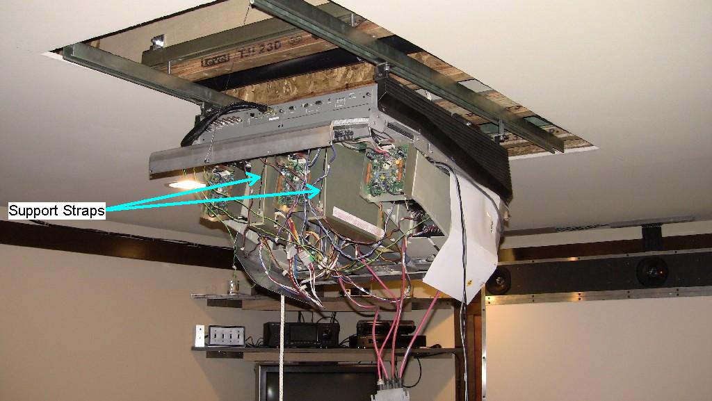

This may seem trivial, but I think it's really worth doing. Both my Marquees are missing what I think was later added to late gen sets from VDC: A simple strap that helps prevent the focus board and horizontal boards from falling out of the projector while working on it on the ceiling. This is one of my most hated deficiencies of the physical design of the Marquee and I wanted to do something about it.
I also think Athanasios' Long Bow versions have these (I think I remember first seeing them in one of the photos he posted when trouble shooting noise problems).
Anyway, very simple mod, costs nothing, super fast and easy, and significantly reduces the threat of falling cards. Next, I'm going to tap the lids for a small fastener so that it's totally impossible to have those cards dislodge while working on the set on the ceiling.
Steve

Posted: Mon May 02, 2011 3:27 pm    Post subject:
I don't think it was the longbows, HKSteve did this to his machine.

Posted: Mon May 02, 2011 3:55 pm    Post subject:
Could have sworn I saw these on Athanasios' sets, assuming it's a recent addition from VDC, but I could be wrong.
Steve
Posted: Mon May 02, 2011 5:26 pm    Post subject:
In added them soon after I saw Steves from switzerland. I have been wanting to do that for a long time and working on the sets over head made it a necessity .
So Yes Steve did see them in my pics.

Posted: Tue May 03, 2011 5:03 am    Post subject:
Except yours are red, right? And much straighter and better looking. Mine came from a twisted pair and I didn't bother to straighten them out. I'm sure what I just wrote is ripe for a joke.

HK-Steve
Joined: 15 Jul 2006
Posts: 849
Location: Switzerland
Posted: Tue May 03, 2011 11:44 am    Post subject:
Thanks for remembering I did them first.
It is certainly a lot easier to work on the ceiling mounted Marquee.
