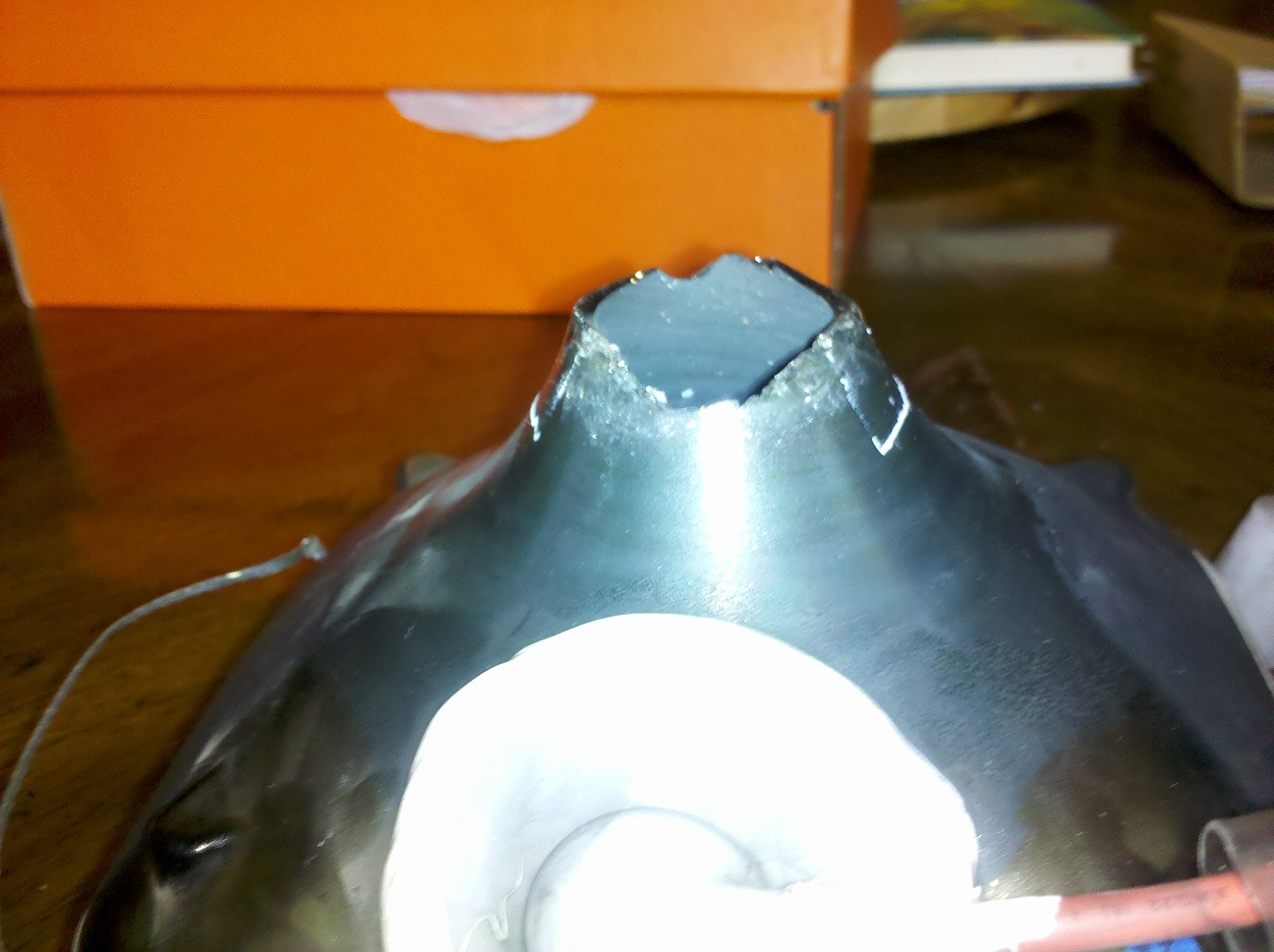

I think I found the problem. My blue tube is imploded! Is changing tubes hard to do?

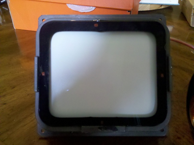

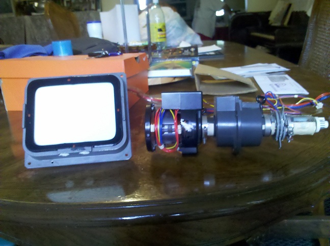

Posted: Sun Apr 17, 2011 10:15 pm    Post subject:
bad tube[img][/img]

Posted: Sun Apr 17, 2011 11:54 pm    Post subject:
ok so i got the blue tube switched out and everything fired up! very bright! but it imediatly shut down when i attempted to move it a bit . it seems like i barely touched it and it turned off. now i get error code fc. anybody got a clue? the green and red lit up really bright and looked to be in focus with the lenses off. the blue was very out of focus and not consistent with red and green. it also was flickering and making popping sounds but i pressed the end button on the remote and the popping stopped.
"To forgive is divine but never pay full price for late pizza." Michaelangelo
Posted: Mon Apr 18, 2011 2:39 am    Post subject:
It is possible that the neck board has a short in it, the V board has gone bad, or it could be something else. I posted a while back about the V boards having issues on the XGs, and I'm offering a repair service on the V board for $100 incl return shipping. You should send in both so you don't crack the replacement tube.
