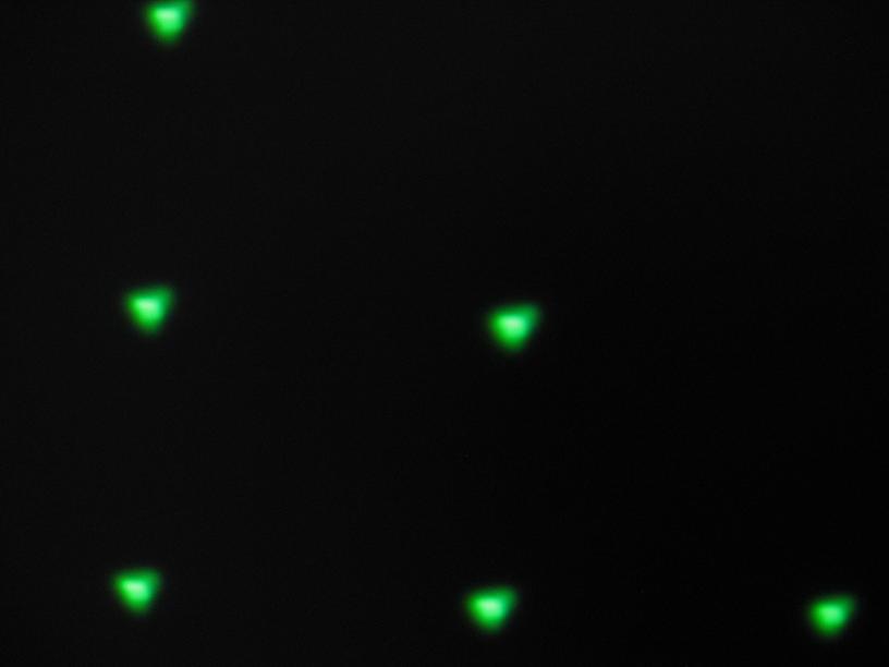

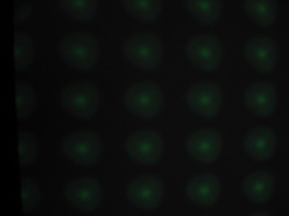

hey everyone. Here comes some pictures on my test patterns for you to judge: I wonder if you think that it woulb be wourth to install 6pole magnets on thin 9500. i have good focis in the center of the picture i thing, the scan lines are visible at 1080p setup but not in the highest scan rate in the internal test patterns, should they be?

the picture did not show up.. hope it works now.

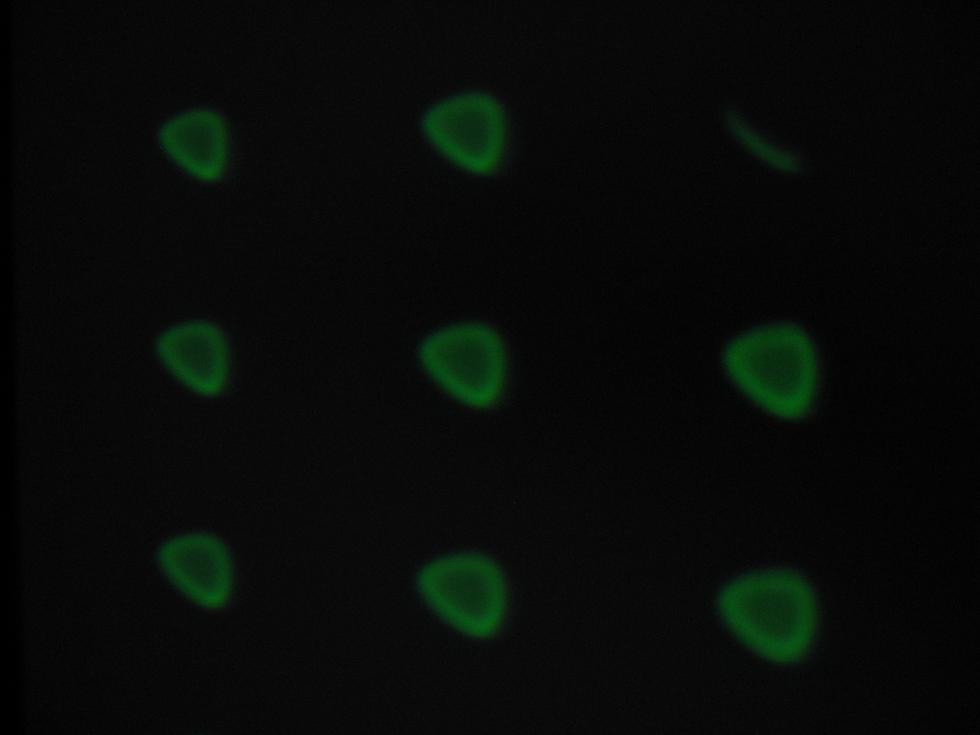

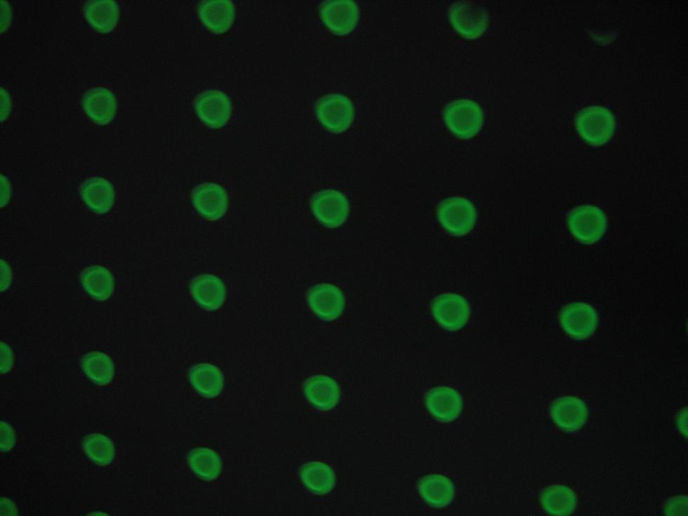

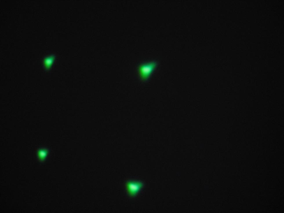

Posted: Tue Apr 12, 2011 5:50 pm    Post subject:
the bottom picture here is to the right corner and is obviosly triangular in shape. One more thing ive noticed is that my left side of the screen is much softer than right side no matter how i move around the PJ or adjusting sheimflug. the astig seems okey so i dont know whats wrong, i turned the seting from retrace short to long and it improved in sharpness a lot on left side but not enough... anyway perhaps the overall focus improves by adding 6pole magnets? its also wierd that when adding my sorce/ps3) the zone focus has to be set different from when using the internal test patterns, perhaps normal?

6-pole will help you for sure.

Installation is easy, just remove neckboard and sheet metal cage, four screws, then loosen clamp for two pole magnets, slide rearward and push new six pole yoke in its' place, reinstall sheet metal and neckboard, maybe ten minutes work for each tube, no need to drop projector from ceiling or remove tubes.
