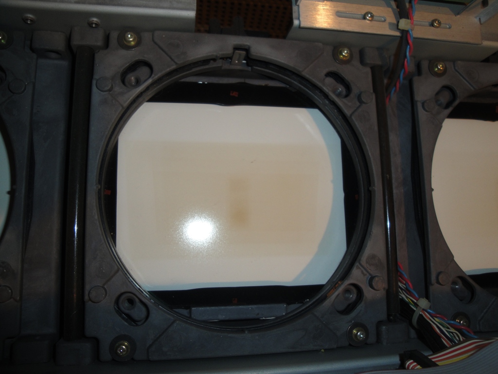

Posted: Wed Mar 16, 2011 5:23 pm    Post subject:
please can you tell me before i pay for nothing is worth to do the change
are the lens in good condition?

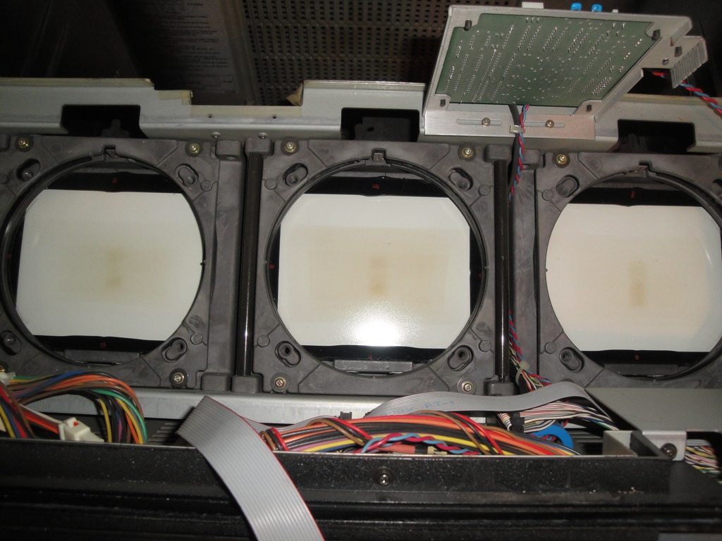

Posted: Wed Mar 16, 2011 5:25 pm    Post subject:
better pic

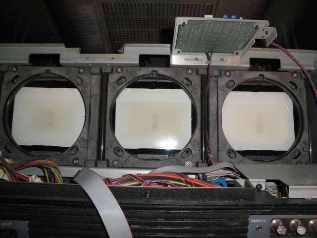

Posted: Wed Mar 16, 2011 5:46 pm    Post subject: the green tube
this is the green tube is it worn or can i still work with this?
the blue and the red also has this stain in the middle but i think that they are in better condition

Posted: Wed Mar 16, 2011 6:20 pm    Post subject:
those are the tubes, the lenses you took off with a screwdriver. No, I would not pay someone to swap those tubes into a working machine.
Those stains are burn marks, company logo or windows Icon that was left sitting and projecting for a long time. Finding nice tubes is not easy, you would have better luck finding a different machine with good tubes in it.

Posted: Wed Mar 16, 2011 7:48 pm    Post subject:
My R and B tubes are pretty good shape, but my green has wear like that with multiple setups. For most movies and video it looks great, but unfortunately i like to watch soccer.
It's pretty darned annoying. Good lucking finding a green for an Xtra though.
