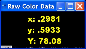

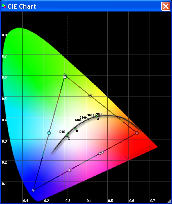

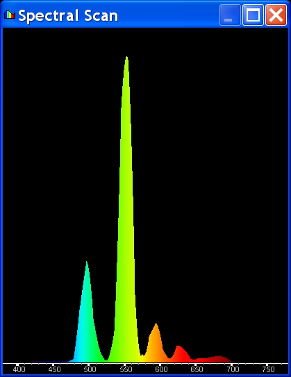

PT22-30 tube - measurements with filtered c-element, ColorFacts & GetragMacBeth Eye-One Pro -
looking directly into lens in dark room.

Razz Thanks Galen. If your eye1 is close this is very promising and MUCH better than I ever hoped. However, the color that the eye1 has the most trouble with is green so I will remain cautiously optimistic until I get a measurement with my PhotoReasearch.
This is exciting Thumbs Up
