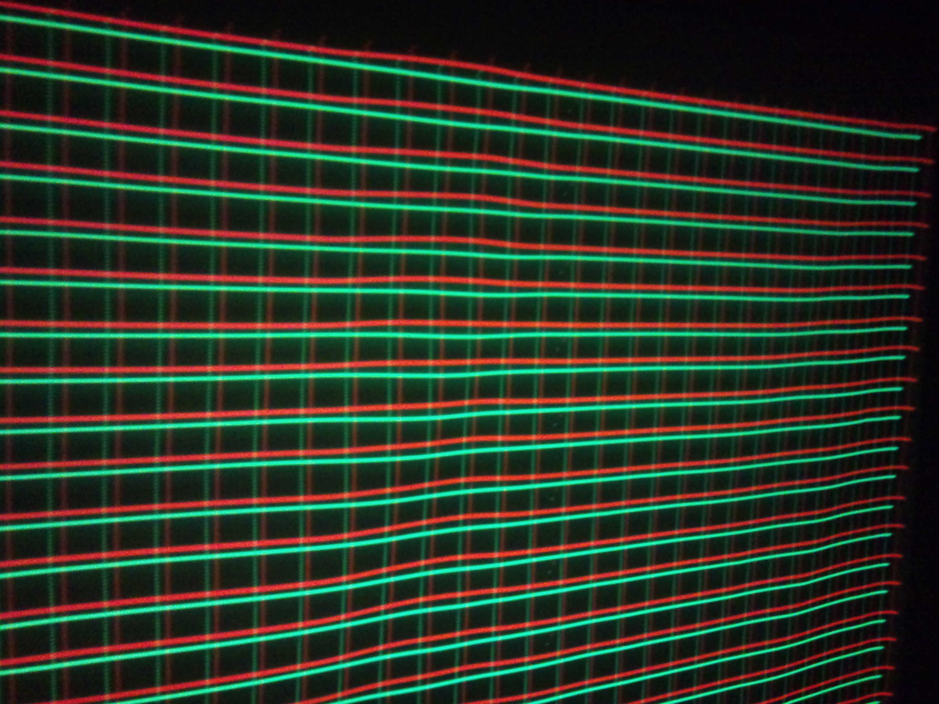

Posted: Mon Mar 07, 2011 2:15 am    Post subject: Picture
Here is a picture!
This is how it looks when i have done the best of the situation. (the reason that it does´nt look configured at all sideways is that i just started the internal pattern. the picture is tweaked for 720p. i have moved the red picture up a bit, so it´s esier to see what i mean. the blue picture is, if not identical, almost so.
red and green (green is straight)
 Filename:  DSC_0139.jpg
 Filesize:  476.83 KB
 Downloaded:  221 Time(s)
Posted: Mon Mar 07, 2011 5:01 pm    Post subject:
OK, that red 'bump'' looks like a component failure somewhere on a board. It could be the H shift board, the V board or the convergence board. I've got all of them, but the convergence board will be about $100 to ship due to the weight and size. The others will be cheaper, about $50-60 or so.
