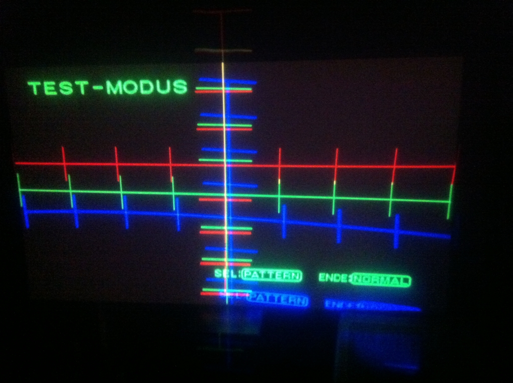

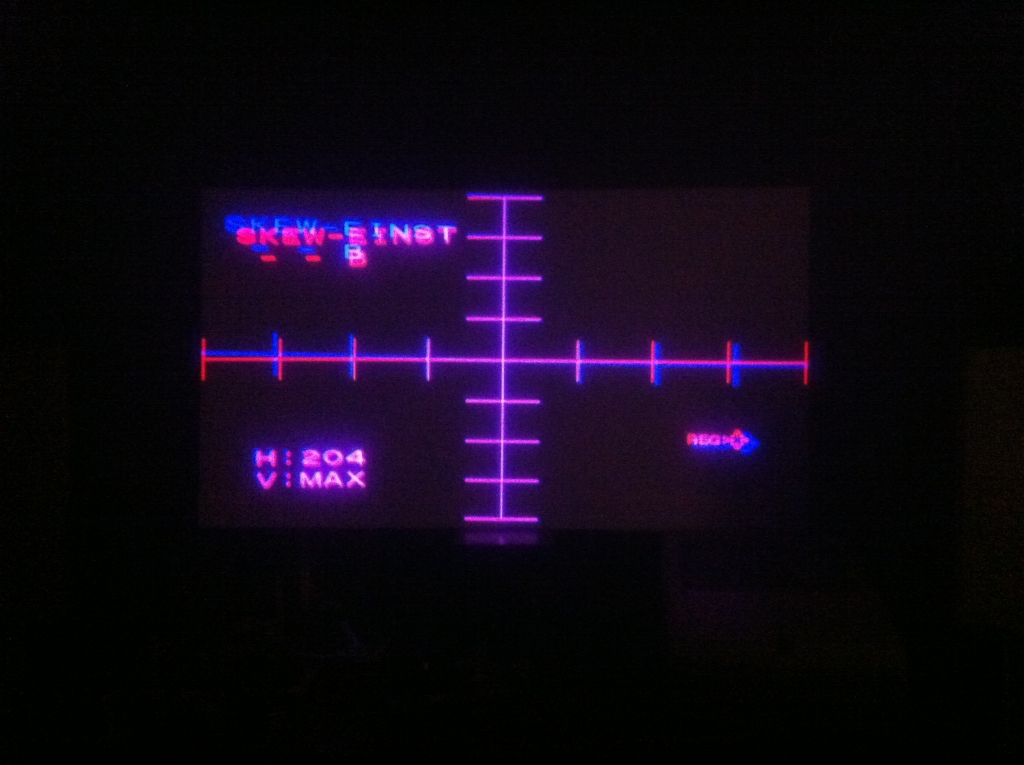

i have a similar problem with G70. I adjusted the convergance without input and it was ok, but with signal on - i just canīt adjust the g70 properly. If you look at the second picture, this is the best convergance i was able to get, the blue tube is the problem. It doesnīt work neitehr with moome, nor with hdfury Sad(( what to do???

Have you toe-ed in the lenses correctly first? Set all electronic settings to their midpoints and then do a PHYSICAL setup first with proper lens toe-in and then do the electronic adjustments. See the manual.
Posted: Mon Aug 08, 2011 1:19 pm    Post subject:
First off, any CRT projector must be converged with a live input signal going to it, at the resolution that you plan to use with the projector.
Second, the center 'ZONE' adjustment is used for coarse V position adjustment. Everything I see about the pix is normal.

Posted: Mon Aug 08, 2011 1:21 pm    Post subject:
Actually i did toed both lenses as you have suggested, the blue tube seems to be very distorted somehow. That wasn't the case by the other g70 i had and which i could have set up properly.

Posted: Mon Aug 08, 2011 1:23 pm    Post subject:
I agree that it looks almost normal but please notice that i can't correct the bow of the blue tube anymore, it's already on max.
You might have a bad convergence board. Can you adjust the blue parameters vertically at all?

Posted: Mon Aug 08, 2011 2:06 pm    Post subject:
with no input i can, but with signal connected i can not. I used 720p and 1080i from two different sources, in both cases the same effect, blue tube distorted vertically with no possbility to cover it with red ang green - very strange.
Also i noticed that green and red seems to be much sharper than blue tube. I do not know the complete history of this particular projector but seller told me all tubes are about 3500 old..
