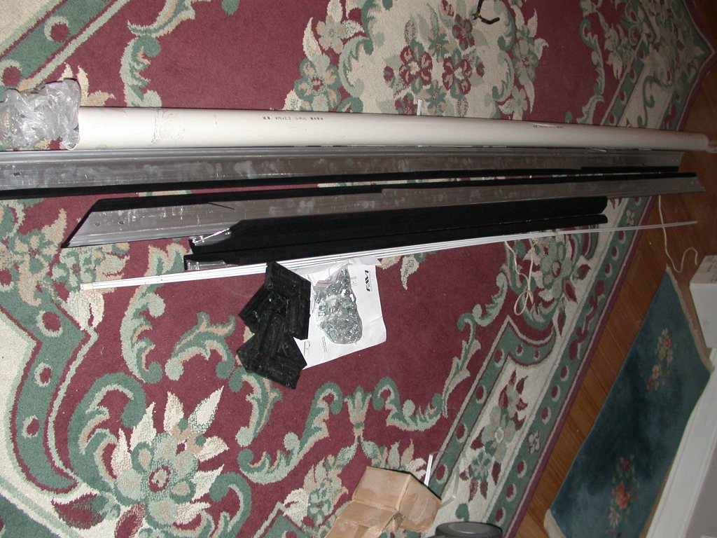

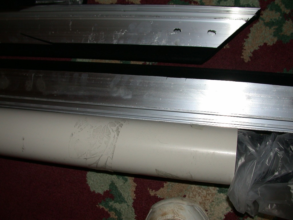

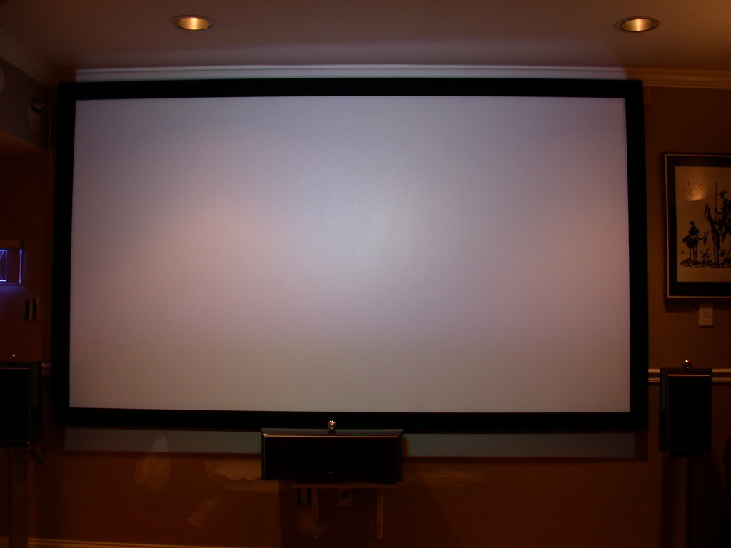

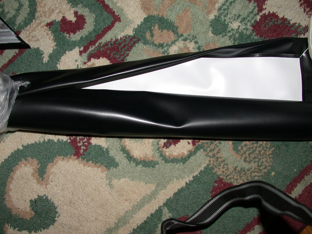

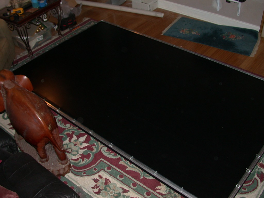

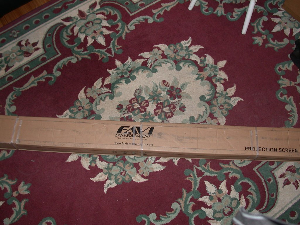

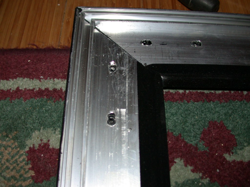

Got the screen setup and I’m overall pleased with it. The frame is made out of extruded aluminum and is quite stout, measuring 3.25" x 1.25" cross section and covered with black felt on the visible side. The screen material has a matte white appearance but is high gain. I have no way to confirm the gain but the G90 is able to drive the 120" screen with lower brightness and contrast setting than the 1.0 gain, 100" (4:3) Da-Lite it replaced. I cannot detect hot spotting or color shifting watching video; however during the warm up screen hot spotting is quite evident and I suspect hot spotting may be noticeable during all white scenes. The screen material is very thin; probably to minimize frame tension. The 42 piece screen tensioners keep the screen flat but are a bit of a PIA to install. I think the design is good but the workmanship is a bit lacking. The frame’s aluminum was dirty. The mitered joints, while accurately cut, were not de-burred. Also the frame’s pre-drilled corners holes looked like they tried to correct the placement but did a poor job. I guess that’s what you get when 11 year old Chinese children work in manufacturing. Anyway the final product is very attractive and does not appear to be “cheap”. I’ve attached a few pictures. At some point I'll calibrate the projector to the screen and will add a few screen shots.

For $250? Man that's alright. I do see the hotspotting in you photo. It doesn't look any worse than my Wilsonart screen.
