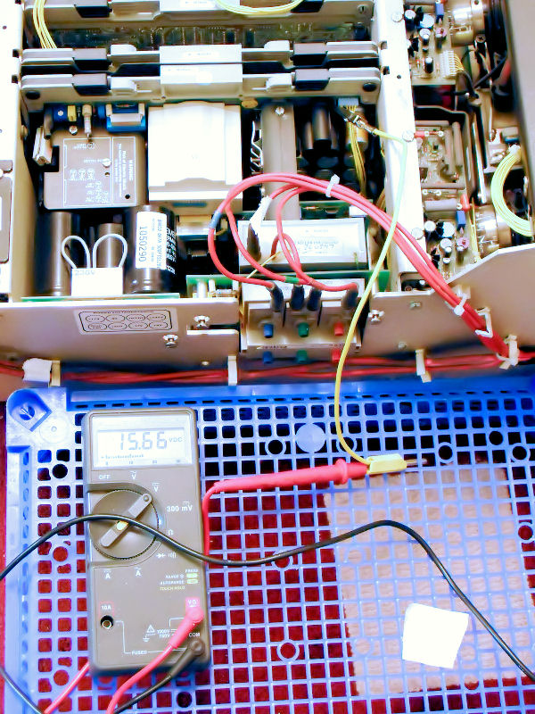

Referencing my 17+ test point I noticed the 17+ trimpot when turned up full can only achieve 15.66v. I've metered various components that pertain to the trimpot and all seems ok - so where should I be looking for current loss?
Thanks for any input.
Paul. Thumbs Up

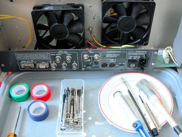

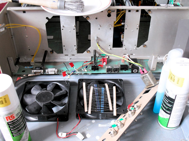

Disassembled and refurbished the back today. Also using Curt's tips section I was able to address and verify what I'd done against the outlined fault pointers guide. Cool
Cleaned and re-soldered wires, metered resistors..

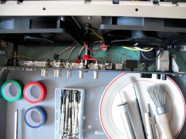

Disassembled, cleaned and treated the pcb. Removed dust from fans, even rust on the metals (previous bad owners)!
 Filesize:  88.53 KB
 Viewed:  7654 Time(s)

Barco 500 Data Owner.
View user's photo album (45 photos)

That could well be the issue. That point needs to be at 17 volts, under 16 and even without the SF, the pix will blank out. Something is wrong with the SMPS I'd think. CHeck the other outputs to see if they are equally low..

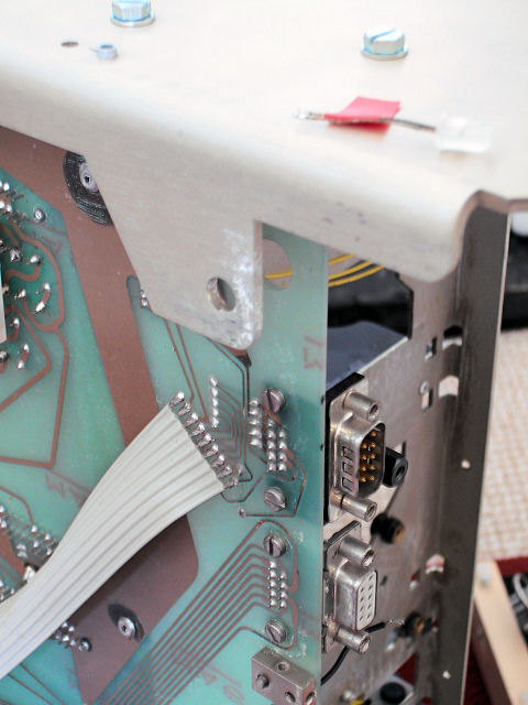

Removed all the rust and corrosive damage, treated the PCB, etc
 Filesize:  79.2 KB

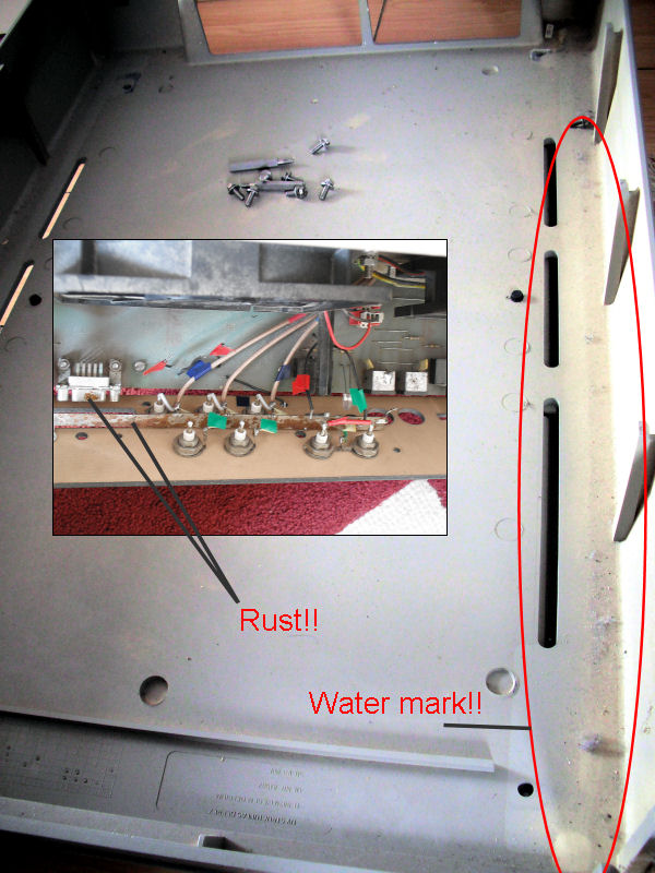

Evidence of water, rust, green corrosive damage on metals/components - all cleaned.

Some damaged (corrosive has been addressed). I've noticed in the bottom half of the casing there is a water stain!!
 Filesize:  64.91 KB

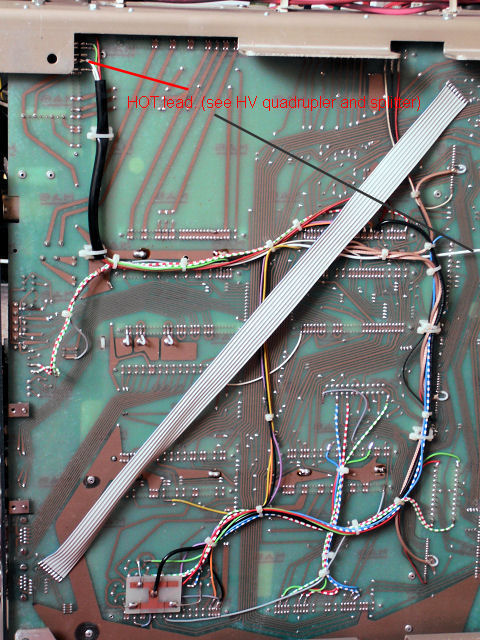

Checked the motherboard, traces etc, all seems good.
 Filesize:  120.6 KB
