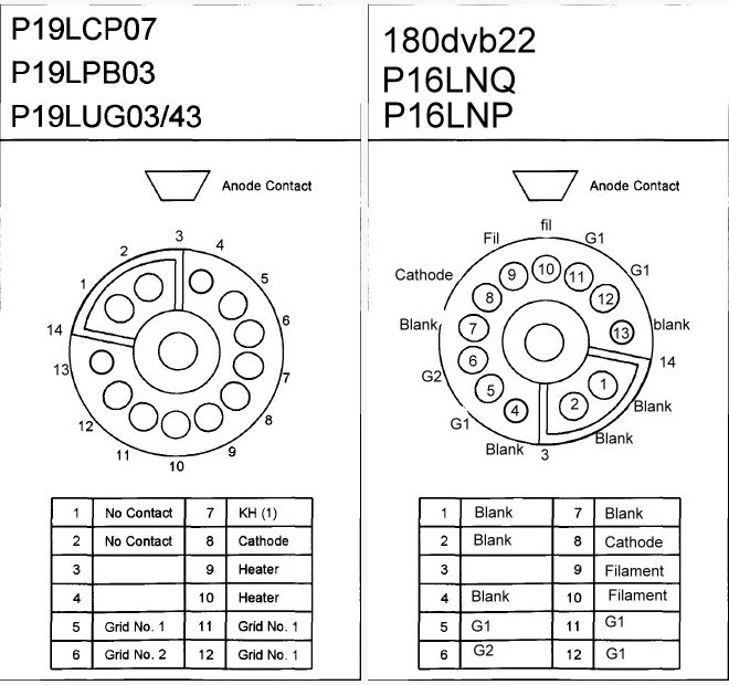

Posted: Sat Jun 25, 2011 11:59 pm    Post subject: another tube pinout question
Can I use panasonic 180dvb22 or P16LNP/LNQ neckboards simply by rotating them 180 degrees in P19LCP07's/LPB's and Lug's?
The socket is rotate but pinout is the same.

Posted: Sun Jun 26, 2011 1:50 am    Post subject:
No one seems keen to answer these questions.
TbX
Joined: 06 May 2006
Posts: 94
Posted: Sun Jun 26, 2011 10:23 am    Post subject:
to use bg1200 tubes in bg808s just connect pin 8 to pin 3 and it vill work
and on p16 to p19 yes you can

Posted: Sun Jun 26, 2011 10:38 am    Post subject:
Thank you Thumbs Up
Domenico (Barco fan!)

Posted: Tue Jun 28, 2011 1:54 pm    Post subject:
I am very confused.
In this document I found the pinout of the tubes 9".
The order of the pins is described in a clockwise direction.
I take photo of the socket of a neck 9"
I see that the real number is counterclockwise
Posted: Tue Jun 28, 2011 2:20 pm    Post subject:
You cant always go by the socket id. What model projector is that neckboard from?
