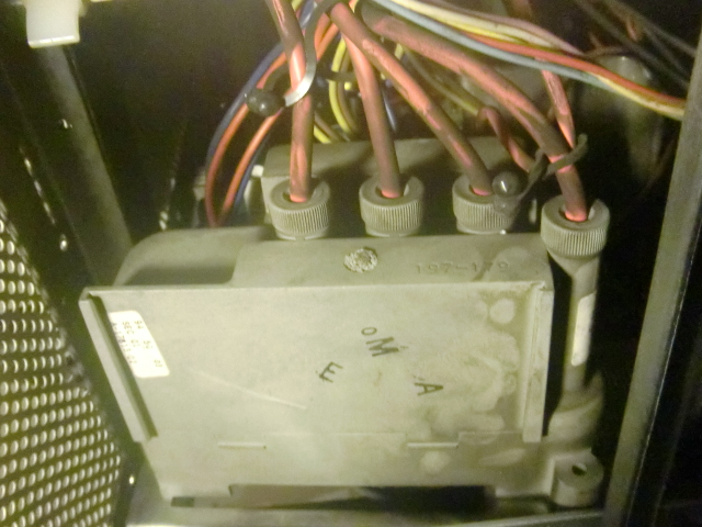

Can you pop the back cover off to see if the focus block is original? Zenith had massive problems with the earlier blocks, but changed to the 2 piece one about 1/2 way through production, and the later ones are really reliable. I'm guessing your focus block is bad, I think I have one left at $150 shipped.

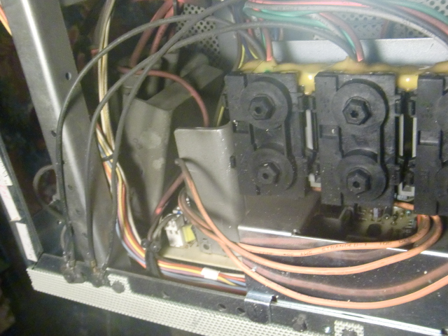

Posted: Wed Dec 29, 2010 1:36 am    Post subject: pro 851x
That's how it looks.Second pic.

Posted: Wed Dec 29, 2010 4:59 am    Post subject:
That's the old style, and virtually guaranteed that's the problem. I replaced literally 100s over the years. I have one new style one left at $150 incl shipping. $100 refund if that doesn't cure it and you send it back. Let me know.

Posted: Thu Dec 30, 2010 11:37 am    Post subject: focus bloc
AS you can see on second pics this is not old style FB.What else might be a problem??
Posted: Thu Dec 30, 2010 1:37 pm    Post subject:
Sorry, you're right. Unfortunately this set has no troubleshooting LEDs, so it could be almost any board in the set. Most likely:
-HV board
-deflection board
-power supply
-possibly the new style focus block.
-CPU board
I can test a number of boards here and can send them to you if you want.
