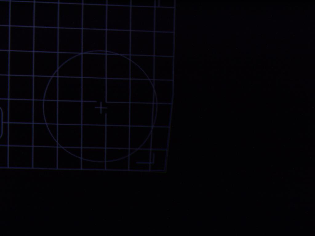

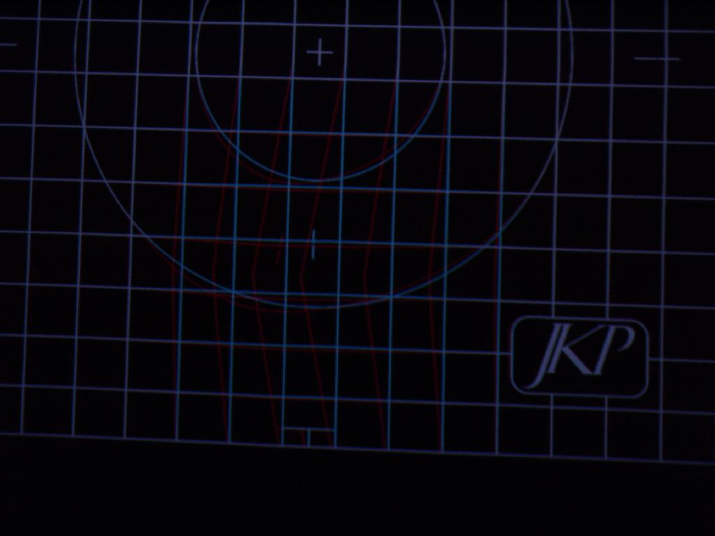

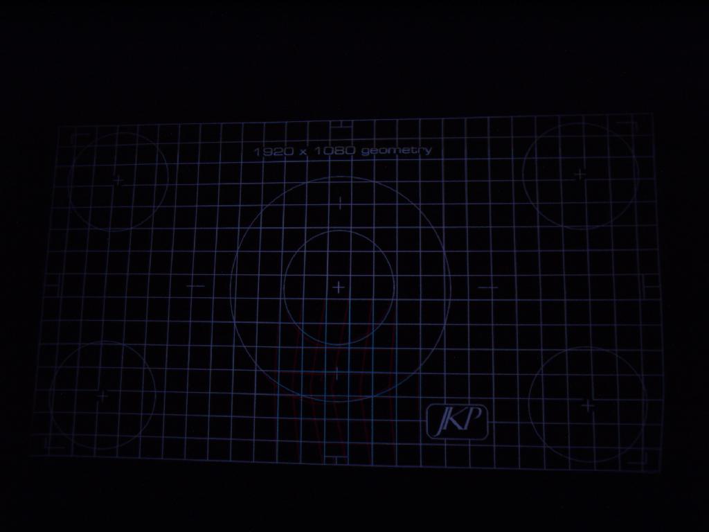

Fired up the set today and this is what I saw. Big glitch on the red in the center of the screen, but all 3 colors are together with a strange geometry deviation in the right bottom corner. I forced both issues back into shape with the convergence, but I'm guessing this is a patch for what's a more serious problem.
Any Marquee users seen this before?
TIA

note big deviation in center bottom on the red, and all three doing something strange in bottom right corner.

Try unplugging the red convergence yoke, see if that takes the bend out.

Looks like my issue on a CLM i have. Do as Tim says, if it stays after disconnecting the CVA red channel cable then its a CLM issue.
I still have to track mine down.

dpb, take it off clean the contacts and put back on, clean the contacts on the main clm too, use ethanol.

No way to reverse the steps. Only way is if you saved the settings to your PC vie the Marquee Loader program
from the RS 232 ports. I suggest to everyone to save their settings after each adjustment or set up just incase you do something like this. It could easily be just a corrupt memory. An Initialization might fix it but then you'll loose all settings.
You could save all settings to the Marquee loader program, initialize the set and then reload the settings, it might fix that issue. Even if it still looks off try to converge that area and it might work.
But first do as Tim said and pull the red's convergence cable from the Convergence Amp and fire it up, if the bend is gone then you may have a bad CVA ,if its still there try my idea and see if its s till there or can be adjusted out. If not then it is a bad CLM.

I'm hesitent to say this but... you can go into the menu 9, 0910, and go to diagnostics where it gives an option to see the last 25? key presses. I think.
I don't know if you can undo anything from there, but maybe.
But even then you might hose everything and need a complete initialization anyway.

Hi Steve, I think an initialization might fix this problem, lets hope.

I had the same issue once on my 8500, the same tube too. After a thorough cleaning of chips, sockets, card edges, etc. it went away.
You'll need to do a full reinit to recreate the problem but saving your current setup and restoring it later after it's fixed will shorten the recovery (setup) time considerably.

i am very sorry for the confusing, you can use ipa of course.
its just that the oxidation layer has to come off so use plenty of it and let it dry for 15 minutes before reinstalling.
hope that will solve the problem.
i had a similair problem on the top of my picture and it was solved simply by cleaning the contacts on the dpb and clm.
