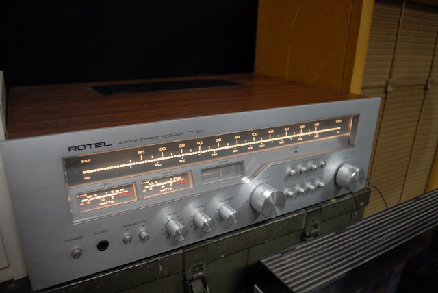

Here's a picture, I'll get some more when I have it disconnected to get it cleaned up.

Great grab...there is only a kenwood local and the guy wants $150 for it.
