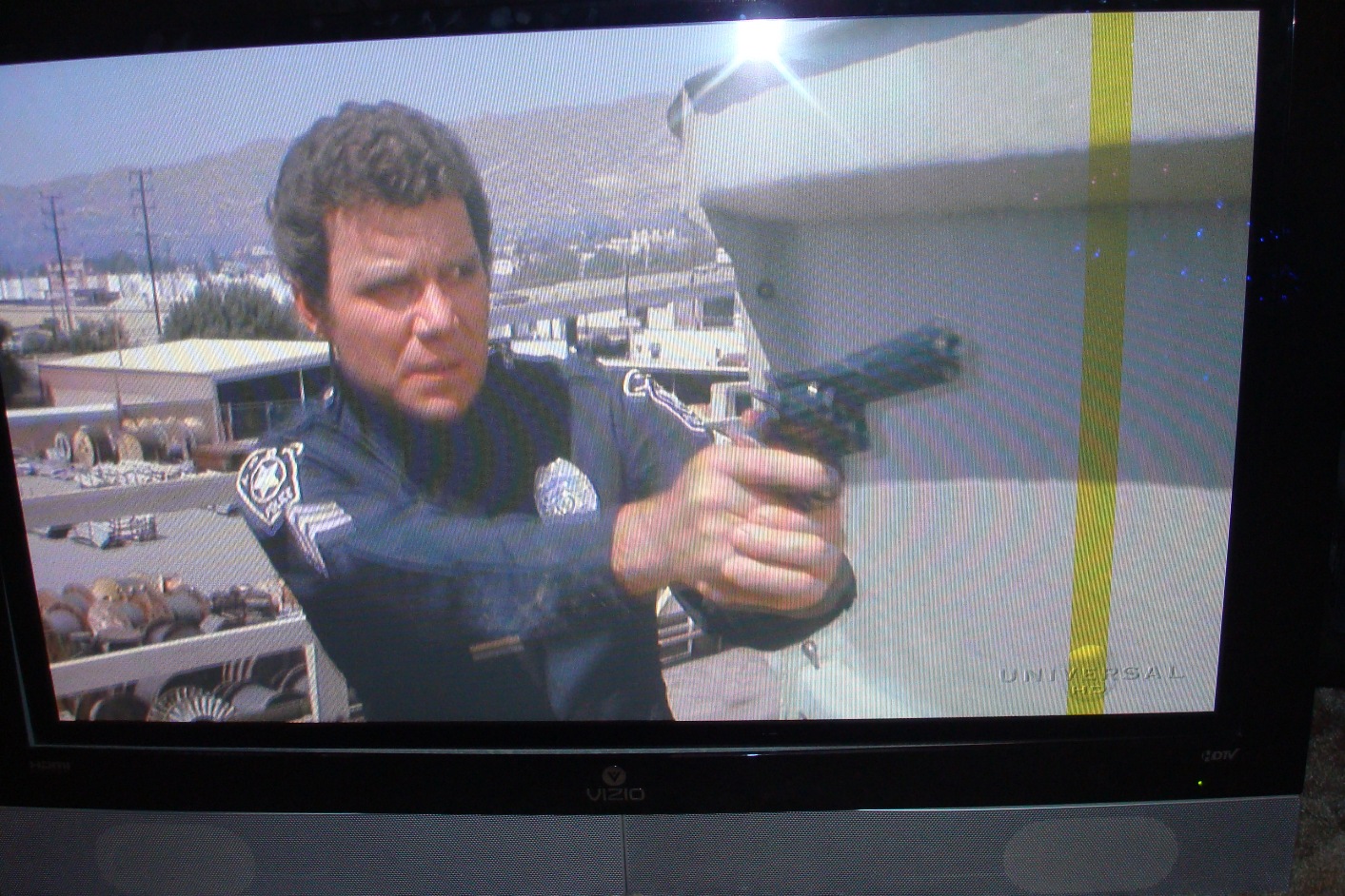

so i got it to show a picture now. it was just stuck on rgb once i connected it to my laptop i was able then to go into the menu and change settings. now i have this yellow-ish line on the right side of my screen please see attachment any suggestion?

Posted: Tue Dec 14, 2010 5:45 pm    Post subject:
So, you were able to control the display from the computer, or you mean you just connected the computer to the input that the display happened to be stuck on?
I don't remember which board it is that connects to the panel with all the little ribbon connectors, but I assume you had to disturb those when you removed the z-sus board you repaired/replaced... So, one of the panel driver connectors is probably not completely connected at the panel or board... That strip is showing lack of blue in that area... Probably a single pin not making contact. Try re-seating a couple of the connectors on the top or bottom of the board/panel, and on that side of the set, then re-booting.

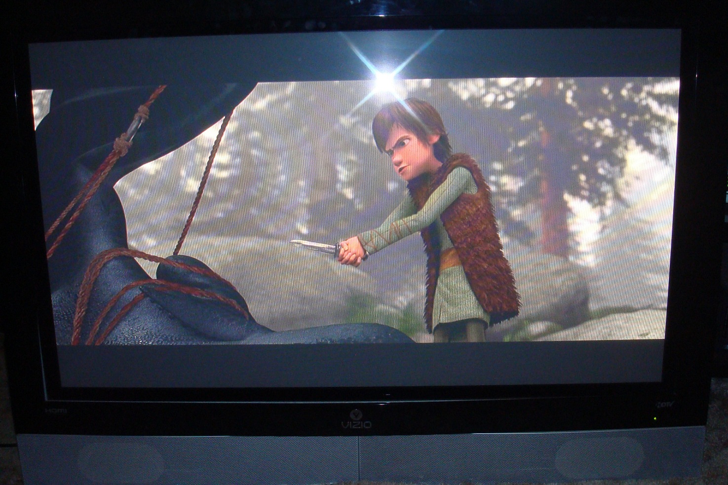

yes it was stuck on rgb and basically didn't want to do anything until it got connected to a computer first... and what do you know that yellow-ish line went away i didn't do anything but i hope it doesn't come back see attach picture.. thanks and goodluck with your tv.
