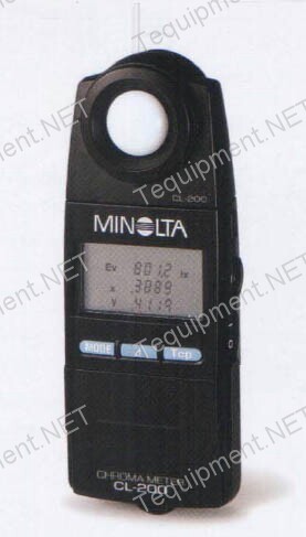

I was recently measuring the ansi checkerboard and was thinking "why are the numbers so crappy?". Then it hit me, I was wearing a white shirt. Not recommended for best readings.
Scott
