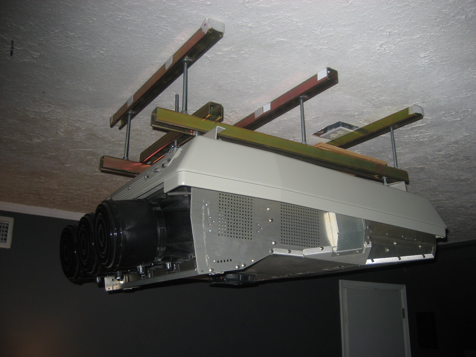

Unitstrut is *perfect* for dropping it 8-9" and having side-to-side flexibility. Mount strut on the G70 at 90° to the strut on the ceiling. Use channel nuts in the top & bottom struts, connected by all-thread rod of the desired length. Slide the channel nuts side-to-side to get your desired location. See http://www.curtpalme.com/MountingMethods.shtm, with longer all-thread. Hopefully you don't have to mount it TOO far off-center or you'll end up with some significant torque on the ceiling strut.

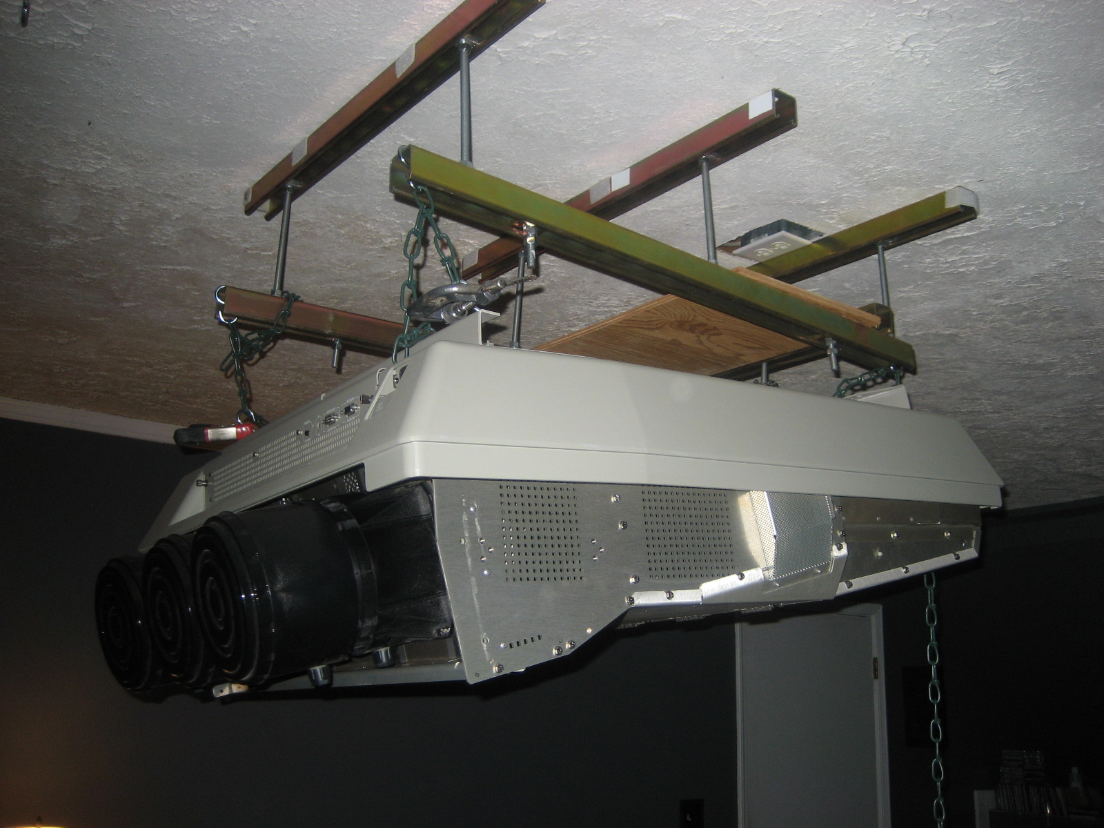

Posted: Sat Nov 20, 2010 3:15 pm    Post subject: unistrut
Barco 1208

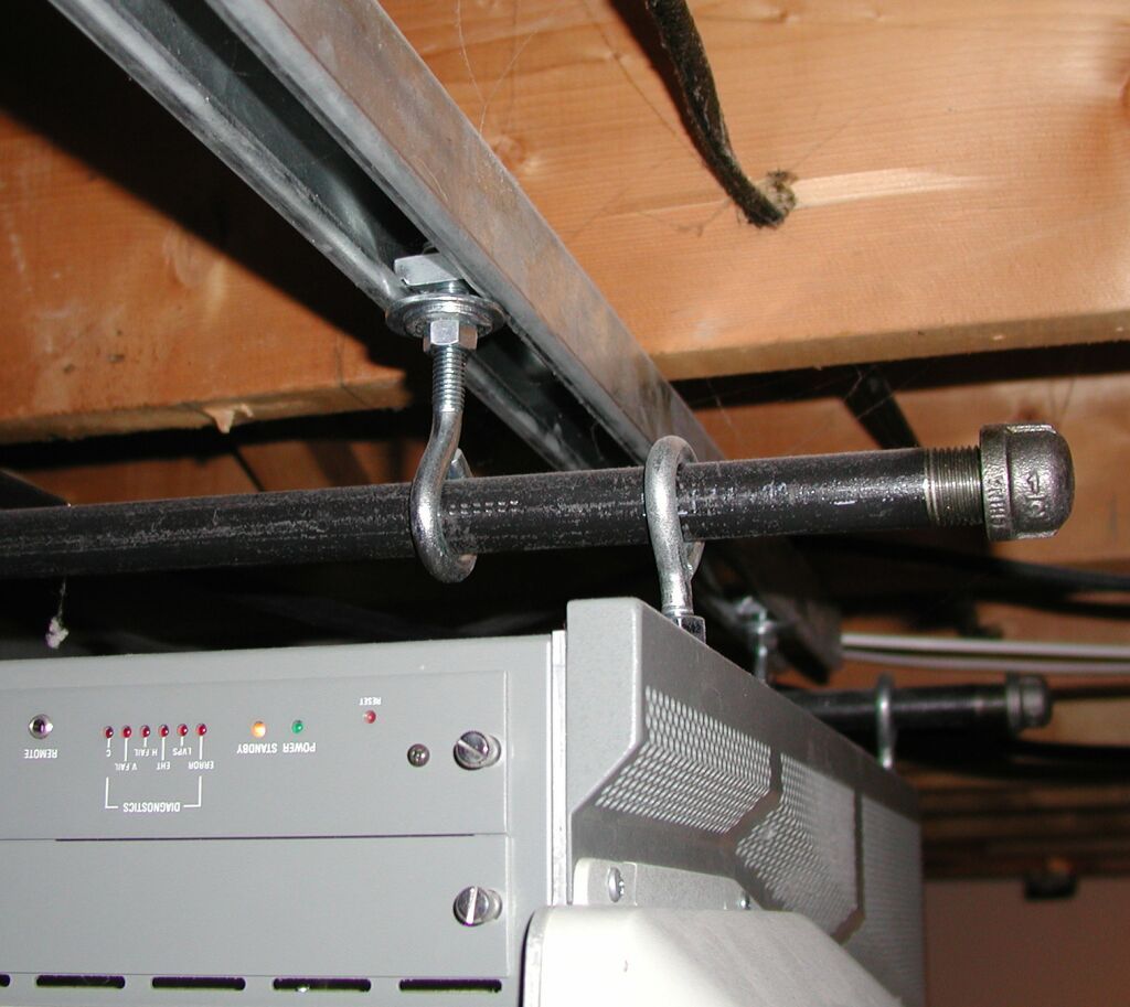

Marquee These eyehooks can be found easily in 6" lengths.

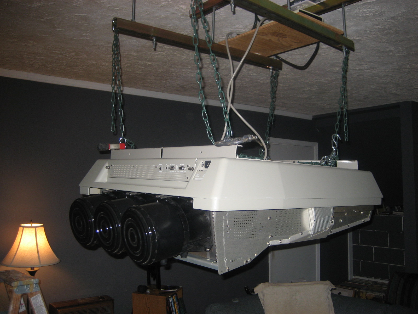

I hung mine by myself. I dont recommend it because it took several hours but can be done. 1208 is 165lbs. I cover the unistrut in black material and the room is dark so you cant see the mount anyway.
