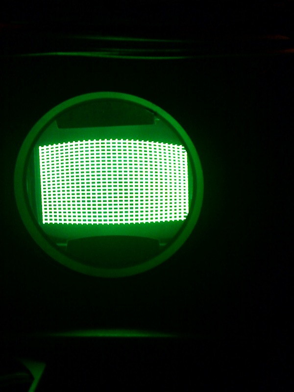

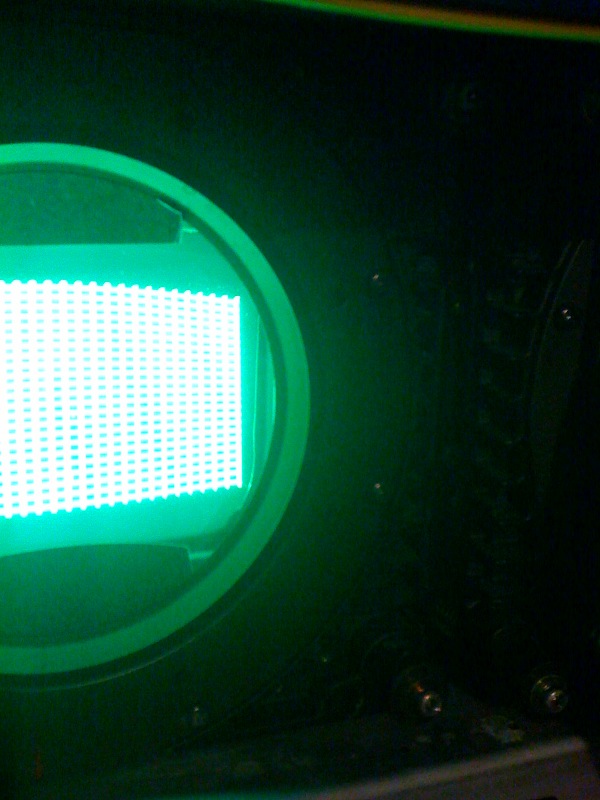

Posted: Wed Nov 17, 2010 4:31 pm    Post subject:
Here are some pics from my iphone of the raster using the internal nec test pattern. It is not correct size as I just put h width to max and bumped the vertical size to approx. They are the same pic just one you cant see the right side of the raster.
How do this look?
The previous Owner had black cardboard stuck on the front of the c element so I never took it off.
This is after setting all internal settings to zero and I had to drop the brightness and contrast down do my iphone would focus on it.

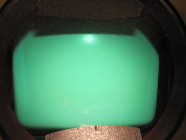

Posted: Wed Nov 17, 2010 4:43 pm    Post subject:
Here is a pic of the green tube the previous owner took. The wear you see on the tube cannot be seen by your eye even with a flash light.

Posted: Wed Nov 17, 2010 8:34 pm    Post subject:
There's no focus problem within the set that I can see. That black cardboard is stock NEC, not sure why it's there other than to perhaps absorb reflections.
