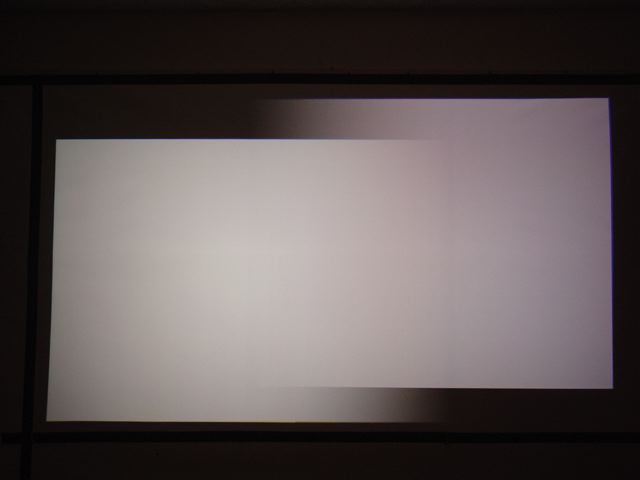

For those not familiar with edge blending, both projectors shoot straight on to the screen, each projector lighting up about 60% of the screen width. This picture shows two Marquees displaying white field, one is blanked at the top and the other at the bottom so the contrast modulation can be seen:

That is one of the best ways I have seen to demonstrate and explain soft edge blending.
Good to see a proper overlap shown too

Thats a huge over lap!!! on a 12 foot screen my over all blend zone is 14 inches about. Tim what percentages does the AnalogWay use, is it fixed or can it be user selectable? With the TV-One you can basically choose what ever zone size and zooming you want.
It also looks like a 16:9 screen...That's much different than I thought the typical blend was setup with "scope" screen.

Overlap is zero (edge butt) to 500 pixels or so, that is a very old picture, I currently use 394 pixels or 20% of 1920 found in HDTV signals.
