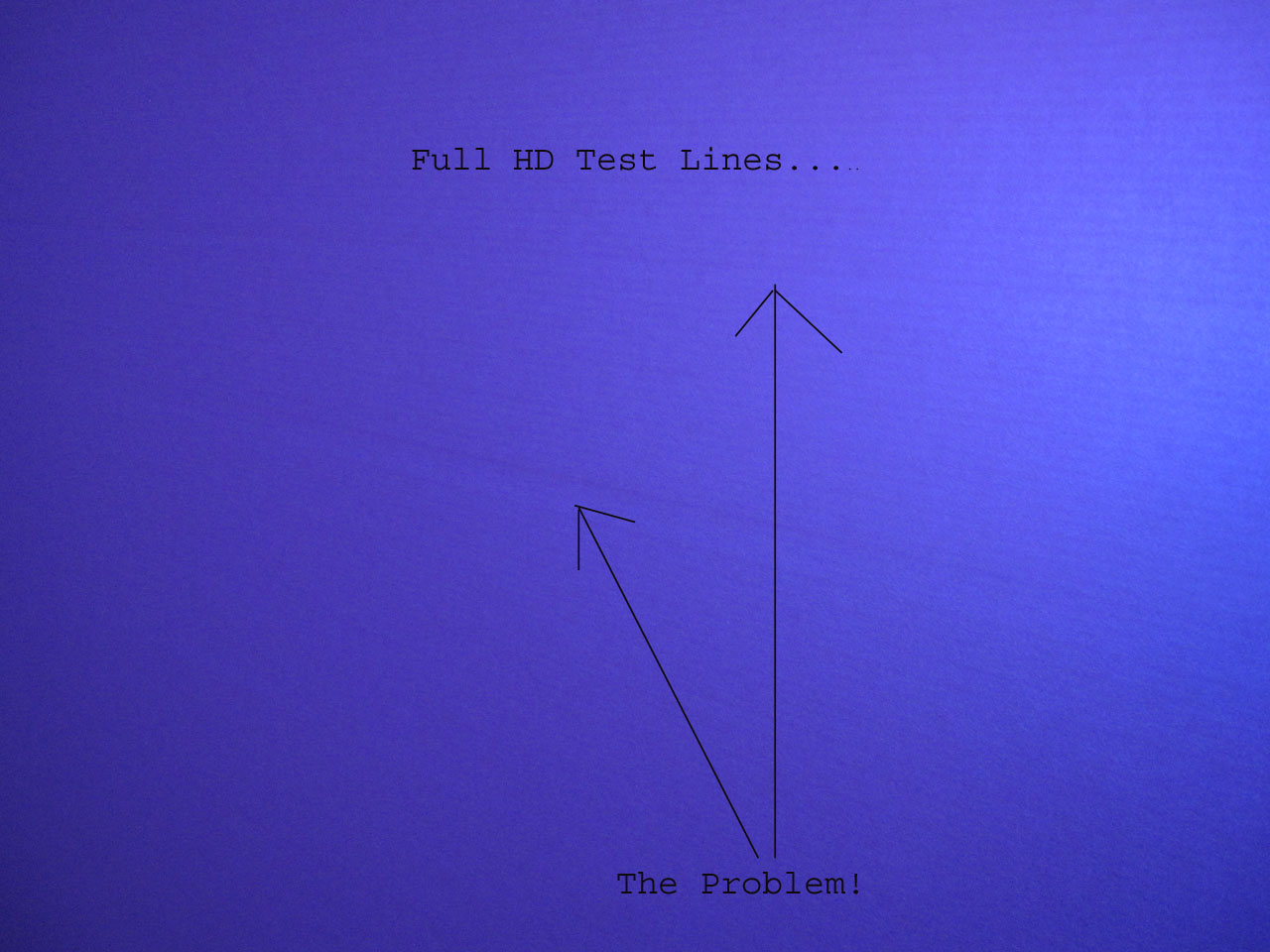

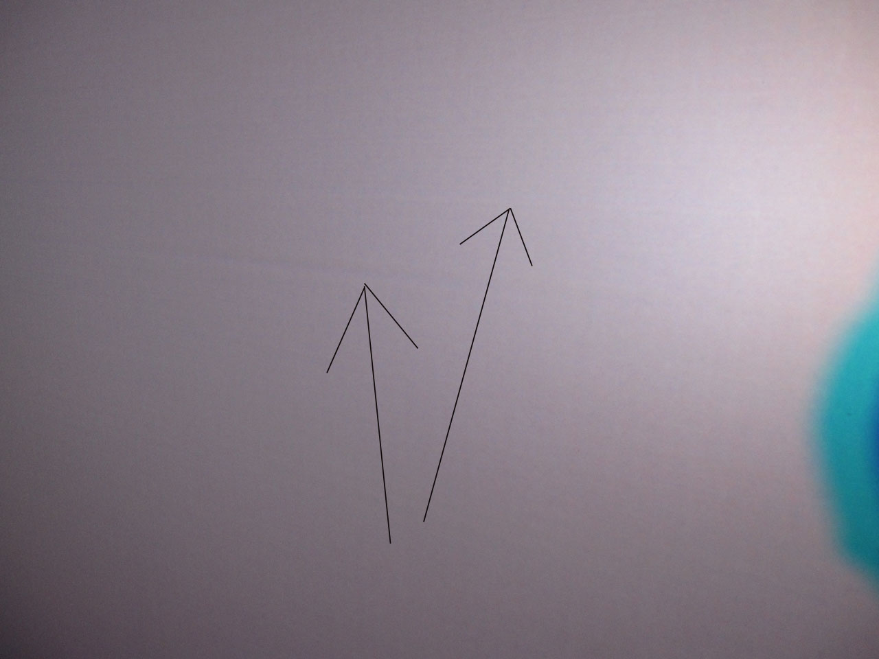

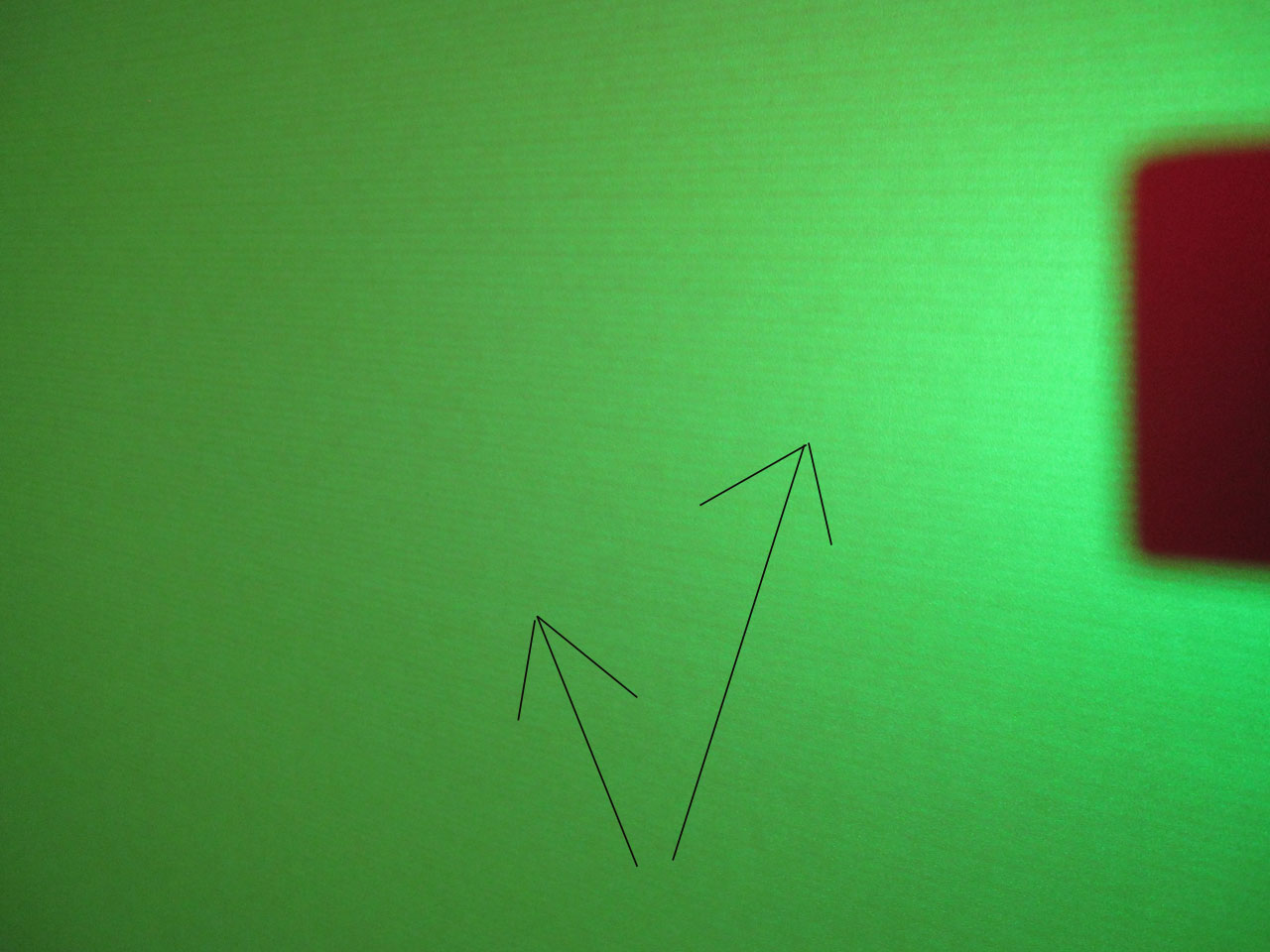

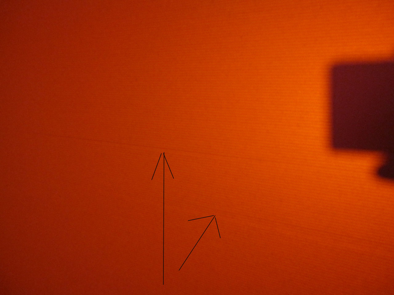

Hello,
i´m solve a problem with my NEC XG110LC Projektor!
My english is very terrible, i attached some pictures of the problem.

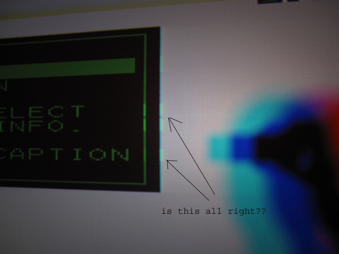

Picture IMG_1132kopie.jpg is this all right???
The other pictures show the main problem...
I have reset all settings in the set but the problem is the same as before.
Thanks!
Georg

Posted: Fri Nov 05, 2010 8:17 pm    Post subject:
Thanks!
Hello Mike,
i´m inserting 1920x1080@48,xx Hz
I have normalize all settings of the set! Point isn´t the problem!
What du you tink about the Picture IMG_1132kopie.jpg??

Posted: Sat Nov 06, 2010 2:15 am    Post subject:
Hi Georg,
When I saw the topic description I immediately thought it would be another case of a distinct line running right across the very middle of the picture, as that is a common problem with the NEC's if too much "vertical linearity balance" is used. Having seen your pictures though, I'm not convinced as it appears on all 3 tubes, however it is worth looking at that first. Check the values you have currently for any vertical linearity balance and reset to neutral and observe any changes ( if any ).
I'm thinking it looks more like a streaking issue though, especially after seeing picture 1132. Try decreasing the BRIGHTNESS control and see if that helps. You might have to decrease it a lot to see if any change occurs. If it does help then I suspect there is an issue with the base WHITE BALANCE settings and THAT is not an easy task to perform.

fftransformation
Joined: 05 Nov 2010
Posts: 4
Posted: Sat Nov 06, 2010 8:27 am    Post subject:
Thanks for your post!
I have all parameter reset!!! Include vertical linearity balance. Exept the color settings.
The Problem is all over red green und blue.
I have a oscilloscope what can i do?
I think it if very difficult to catch (trigger) with the oscilloscope.

Posted: Tue Nov 09, 2010 6:33 pm    Post subject:
Hello,
Both of Problems @ differently resolutions!
Ideas about? especially about the curved lines in the middle of the picture?
you see it on the first with horizontal full-hd tv-lines testpattern , it looks as 2 lines squeezing!
Georg
