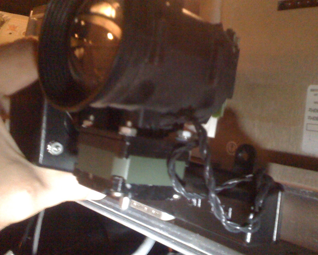

I need some advise on how to install Acon camera on my Vision 1 as I can't figure how to do it.
I advise will be greatly appreciated.
Do you need an adapter plate to mount the acon camera to Vision 1?
 Filesize:  266.53 KB
 Viewed:  1636 Time(s)
Posted: Mon Nov 01, 2010 1:57 pm    Post subject:
Hello
Vision One's with Acon have different front panels that are cut out to make room for the sensor ("camera") and have a mounting bracket made special that the sensor is fastened to.
Picture here: http://vgonpic4.tempdomainname.com/i/c/f/1281197728.jpg

Thanks Tim but I'm not sure how was it mount on the inside.
Anyone with Vidikron Vision 1 able to show me exactly how this is done?

Posted: Mon Nov 01, 2010 6:42 pm    Post subject:
On a regular Marquee, it's just mounted to the power supply bay cover plate using three 3/8" long standoffs, secured with 6-32 philips pan head screws front and rear.
On a Vision's case, obviously there will be some differences. Exactly what they are, I'm not sure.
