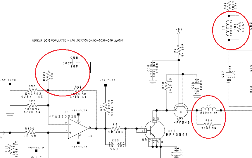

The Mot parts are definately the best for this application (the parts on the neck card have the same characteristics as the ones attached other than increased power dissipation because of the package that allows attachment to heatsink).
Sanyo made a line of video output type transistors that could be used for higher bandwidth amps but at lower voltage than needed for the projector CRTs (ok for monitors).
There are a couple of Sanyo parts with the voltage needed but required more overdriving at the limits of bandwidth to match the Mot parts.
I believe that technique could be applied to the Mot type neck cards to get increased bandwidth over standard cards. Peaking network like C68 and R101 could be added to a better opamp. L1, L2, L3, and L7 should be lower value (to resonate at higher frequency). Probably, R84 and R85 should go away. R16 and R24 values would have to be optimized. L4, L5, and L6 might have to be slightly different value.
If attempting this I would recommend first replacing the inductors with 0 ohm jumpers and setting the peaking network for quickest rise and fall times at amplifier output. Then place the inductor values to get the shortest rise and fall times.

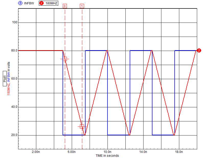

if i understand correctly this peaking isnt dependent on resolution but only sets the amp for fastest rise and fall with the proper inductor values.
very helpful answer, thanks again.

If rise and fall time is fast enough then the ringing and overshoots from overpeaking can be avoided. It also allows the amp output to be at "black" or "white" for a longer time which makes the pixel more distinct. The pic shows 0 rise/fall time and tr/tf = 1.9ns (10 to 90% of peak to peak) with pixel on/pixel off video at 400MHz pixel clock. BW can be approximated by 0.35/tr (or tf) or tr (or tf) can be approximated by 0.35/BW.
Those inductors would be good choice. High Q above 100MHz and self resonant frequency above 200MHz.

Posted: Mon Nov 08, 2010 4:56 pm    Post subject:
getting the peaking right should be done first.
when doing peaking brightness is increased because the hor resolution isnt attenuated as it was before.
you will actually need less gamma because now i have much more shadow detail with a lower gamma setting.
g2 didnt have an effect from what i saw on the peaking its only the contrast setting so once set do not touch the contrast button.
i really want to play further with the neckboards to see if this horizontal overshoot can be reduced so i get an almost black white 1 on 1 off.
