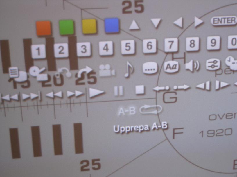

i will post some pictures and perhaps you can tell me if you think im getting maximum out of the projector and if not what improvements i can do. i do have a little convergence drift as well. should i get some of the hd mods?

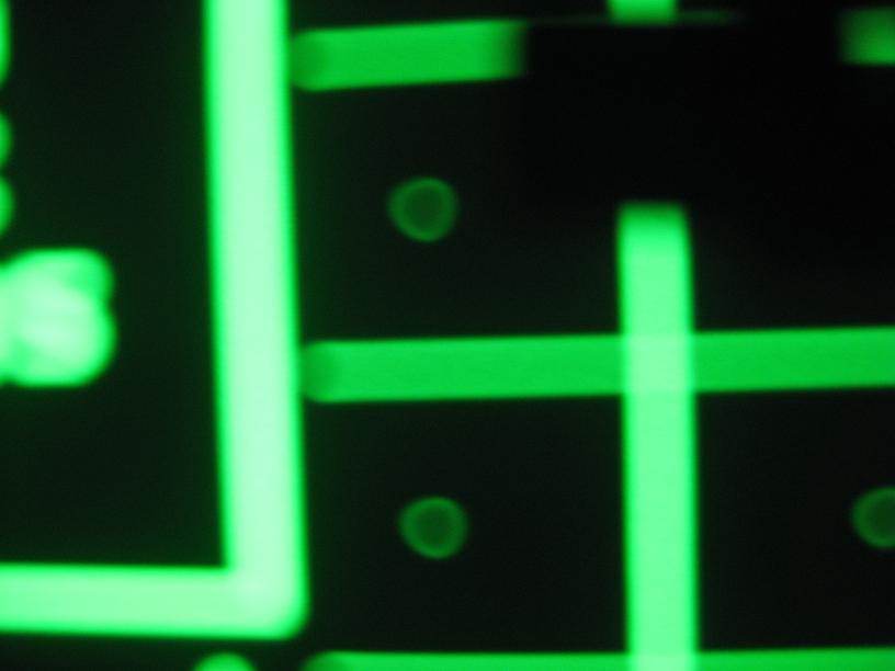

astigs on green. its still moving a litle bit if going from under to overfocused state.

First, what model projector do you have? I can tell its a CRT.
Second, its almost hard to tell if its CRT or not until you look to the left of the first image you posted, and you can see that the edge is out of focus compared to the center, and what looks to be a significant enough amount... Unless thats the camera
Otherwise, I'd say you got yourself a nice looking picture, really nice, that a 8 or 9"? Smile

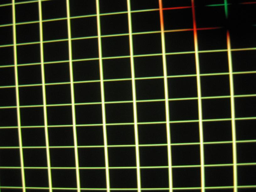

nice looking picture, grid lines in pic 3 look a little on the fat side inidicating a stock marquee AFAIK tell from the shots posted. Focus can be tightened up, convergence stabilized, and that foggy looking haze removed with servicing /modifications to the circuitry.

one more thing ive noticed is that the blobs in defocused mode are way smaller on green than the other colors, i dont think green is as sharp as blue and especially red. is this normal? I know that blue should not be sat as sharp for greyscales...

Make sure when you do convergence the PJ is warmed up for at least 30-45 minutes. One other thing to do after this warm up period is to loosen the LC housings a little . adjust the grids manually if you can. Slightly tapping the lens to move them ever so slightly. then tighten them all down really tight.
Now do your electronic convergence. next time it should be pretty well aligned after a 15-30 minute warm up.
But changing the key Caps and resistors on the rear heat sink boards will lessen the warm up time.
If you can find a cheap Lumagen HDQ or HDP it will be a nice addition to have 11 point greyscale and gamma adjustment.
But overall its looking very very nice.

thanks for the convergence tips! how is the grids adjusted manually? the biggest reson im doing it all over again is that the convergence are drifting apart a little every time i turn it on and off. Ive red that it could be fixed with the mods to? or if the problem is that ive stressed the remote settings to much instead of centering everything mechanically? is it some magnets for it? i've tried to center them with the focus coils, is that wrong way to do it? ?
You should zero out convergence first, then center the rasters by loosening the Brass wing nuts on the focus coil and osciallting it like a hoola-hoop. static raster centering isn't done through the Conv. circuit anyway, it's delivered through the sweep coils. My 8500 was drifting all over the place. Even after a full warm up it was always out somewhere and it's why I started offering the mod's. A few nights ago I showed Curt my Convergence from a dead cold start and I think he was impressed. It was 90% converged dead cold and 99% perfect 15 minutes later.
