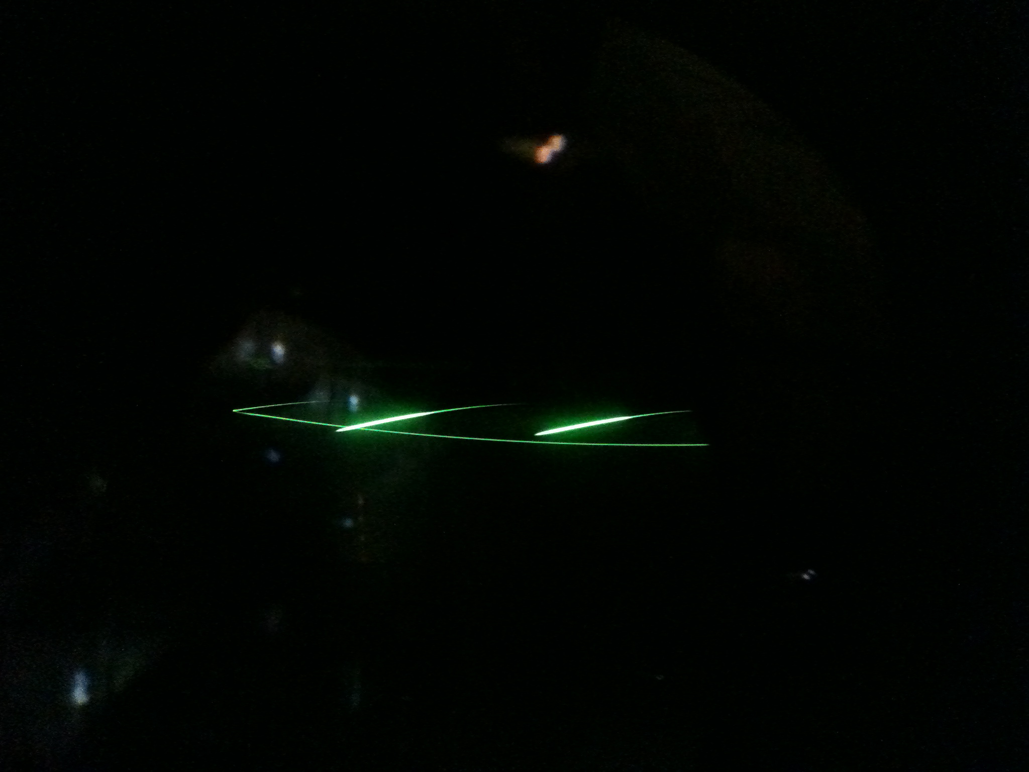

Can someone help to identify the cause(s) of no picture?
The phenomenon is like:
1. The projector could be powered on and when pushing "ADJ" button, the screen shows with beautiful internal pattern.
2. When selecting RGBHV, S-video or Video input, the RGB switch card LEDs changes accordingly, but there is always no picture. And when looking into the CRTs, at the bottom section of CRTs, there are lights moving horizontally.
3. I replaced one quad decoder sent by Curt, but still the same situation.
4. When switching to internal pattern, the red LED on sync vertical board disappears. When switching among channel 1, 2 and 4, the situation turns to be like described in the 2nd point.
5. When projector is on, on the controller there are LEDs showing on Standby, Main power, Processor cycles and Block match.
Thanks a lot for any hints provided and suggestions to replace board(s). [img][/img]

There is no message of text at all. The inside CRTs are just like very very dim color with horizontal scanning going on. Since the CRTs can not be on (dim and h scanning), there is not any display showing. Only when the projector is going on "ADJ", the three raster is on with adj menu, but no text message at all. Do you have any hints? Thanks!
