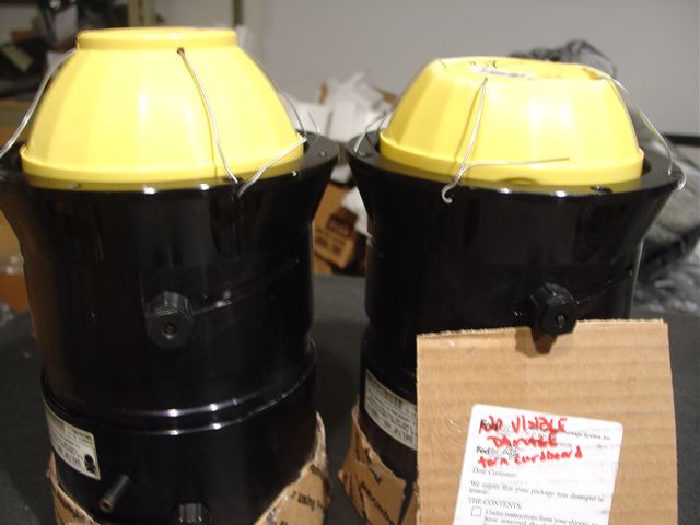

Posted: Tue Oct 19, 2010 3:38 pm    Post subject:
Guys
The thirty-nine cent cereal bowl lens cap from the grocery store; the one on the right took a pretty good hit and saved the lens. For HD10-series you want 5.5" diameter bowls.

Posted: Wed Oct 20, 2010 1:51 am    Post subject:
I can attest to the Tim Cereal bowl method. Both received and sent lenses with this method, and everything was A-OK.
