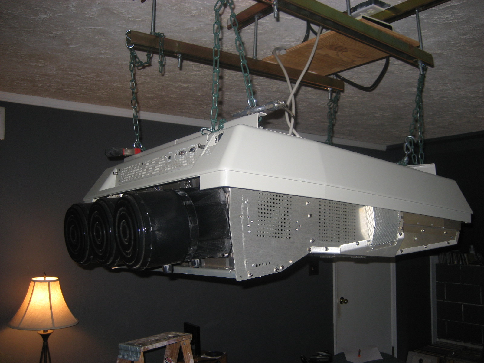

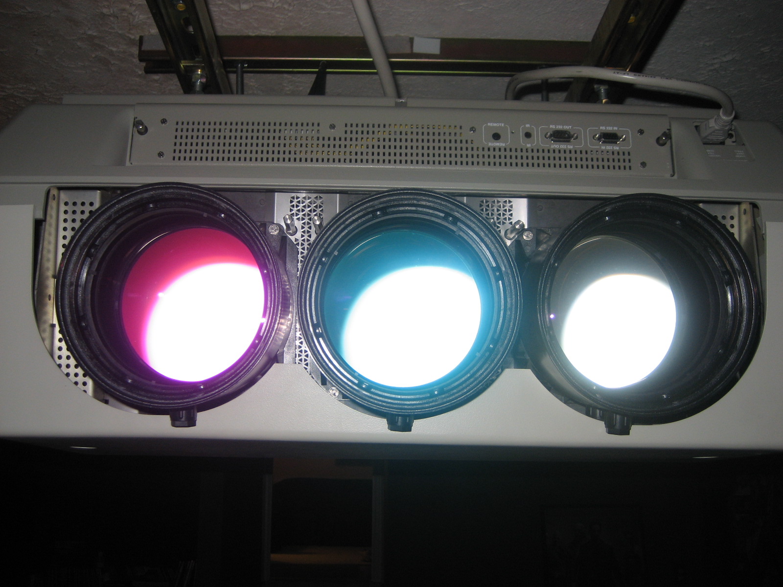

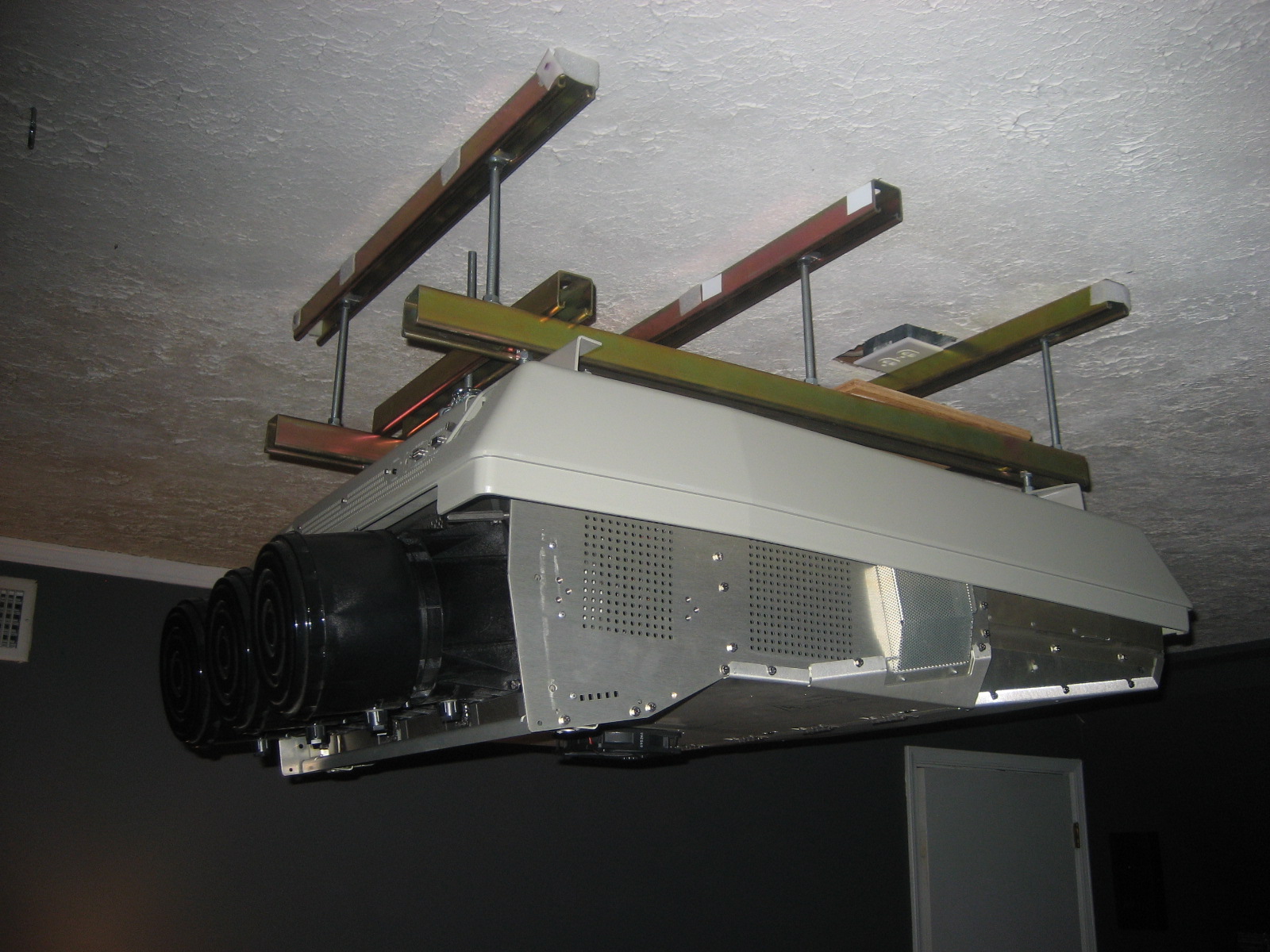

I got my new to me 1208 (450 hr of run time) on the ceiling and it so far is great. Used the chain method by myself and will never do it again it was not as easy as it looks. Fresh tubes make a huge difference the 808 it replaced had 12000 hrs green replaced 1000 hrs ago dont know how old the blue and red were. It is a little quieter than the 808 the only thing I miss is the coarse convergence adjustment is there any adjustment on any boards that will help with convergence? If the red is set to 50 in all zones and the center zone is lined up the left side is off almost a full block off so I have to use a lot of convergence adjustment to correct. The coarse adjustment would correct this. Any ideas? Thanks.
