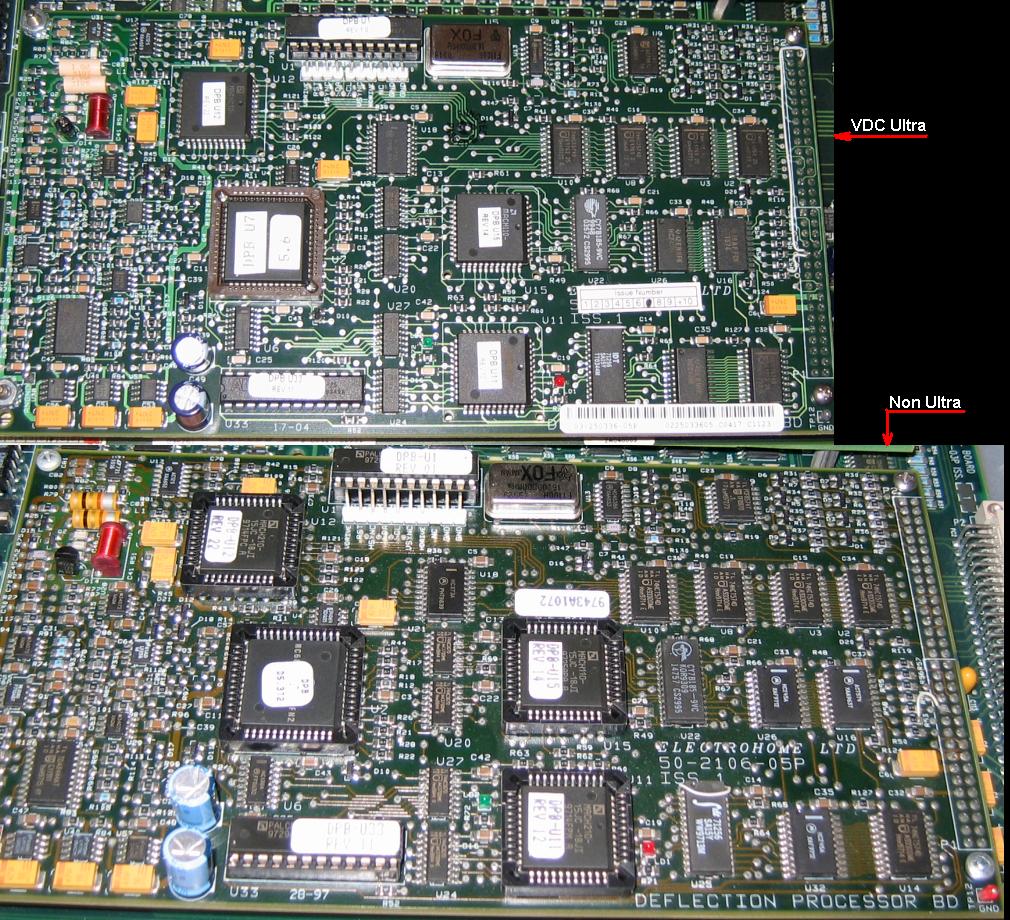

I have a VDC Marquee 9500 Ultra that started to have some deflection issues. If the projector is cold never fail. I already removed and cleaned the chips on the CLM and most of symptoms despaired. I’m pretty sure the problem is on the CLM and it should be a bad contact. This CLM version has most of the chips soldered, only 4 chips still use a socket (2 on the DPB and 2 on the CLB). I suspect that the U7 chip is the culprit.
I have a spare CLM, but is not an ultra type.
My question is: Can I plug the non ultra DPB in the ultra CLM?
From my point of view both DPB are identical and the chip versions are also identical except the U7 (Non ultra U7 Ver. D5.3T2, ultra U7 Ver. 5.6).
Beside the chips sockets both CLM are identical, the only difference I found is the U7 version.

you can do that to test if the CLM is bad or the DPB. but there are some fly wires you can add tot he non ultra to make it an ultra and then check the chip versions.

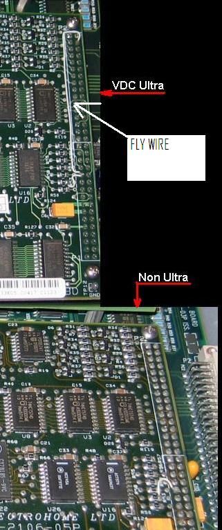

Athanasios it will be great if I can convert the non ultra CLM into an ultra version. Do you know the fly wires I should add?
Posted: Mon Oct 11, 2010 11:42 am    Post subject:
its not the CLM its the DPB that has the added wires. Just look at your ultra DPB.

Posted: Mon Oct 11, 2010 4:29 pm    Post subject:
it's just 1 wire, this one

Thanks for the replays. I already added the fly wire on the DPB and replaced the complete CLM.

Did you make sure you placed all the right chips together? I would make sure you take all the CLB chips that were on the ultra and place them on the non Ultra CLB and if you made the non ultra DPB into an ultra make sure you change those chips over as well.
from your pic it looks like the DPB on the ultra has a 5.6 U7 chip vs the 5.3 non ultra chip. that can make the unit show that error.
