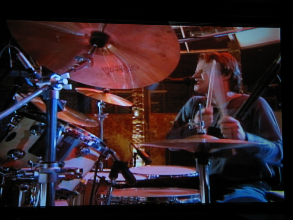

Here is one pic having over-shifted the picture; and a second pic after shifting back. Don Henley is happy again!
Here is one pics having over-shifted the picture; and a second pic after shifting back.

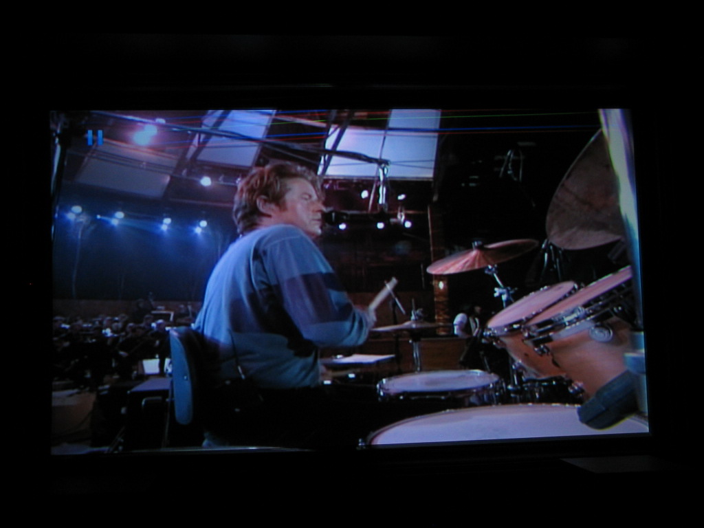

Posted: Mon Sep 27, 2010 3:36 am    Post subject: Picture with the Color Lines On Top
Here is the pic with the color lines on top, having over-shifted the picture.

Posted: Mon Sep 27, 2010 7:21 am    Post subject:
adjust your top blanking
AFryia
Posts: 965
Posted: Tue Sep 28, 2010 11:13 pm    Post subject:
I don't know if the term is correct but it looks like the image is about to "fold over". Try adjusting you vertical shift, porch size.
