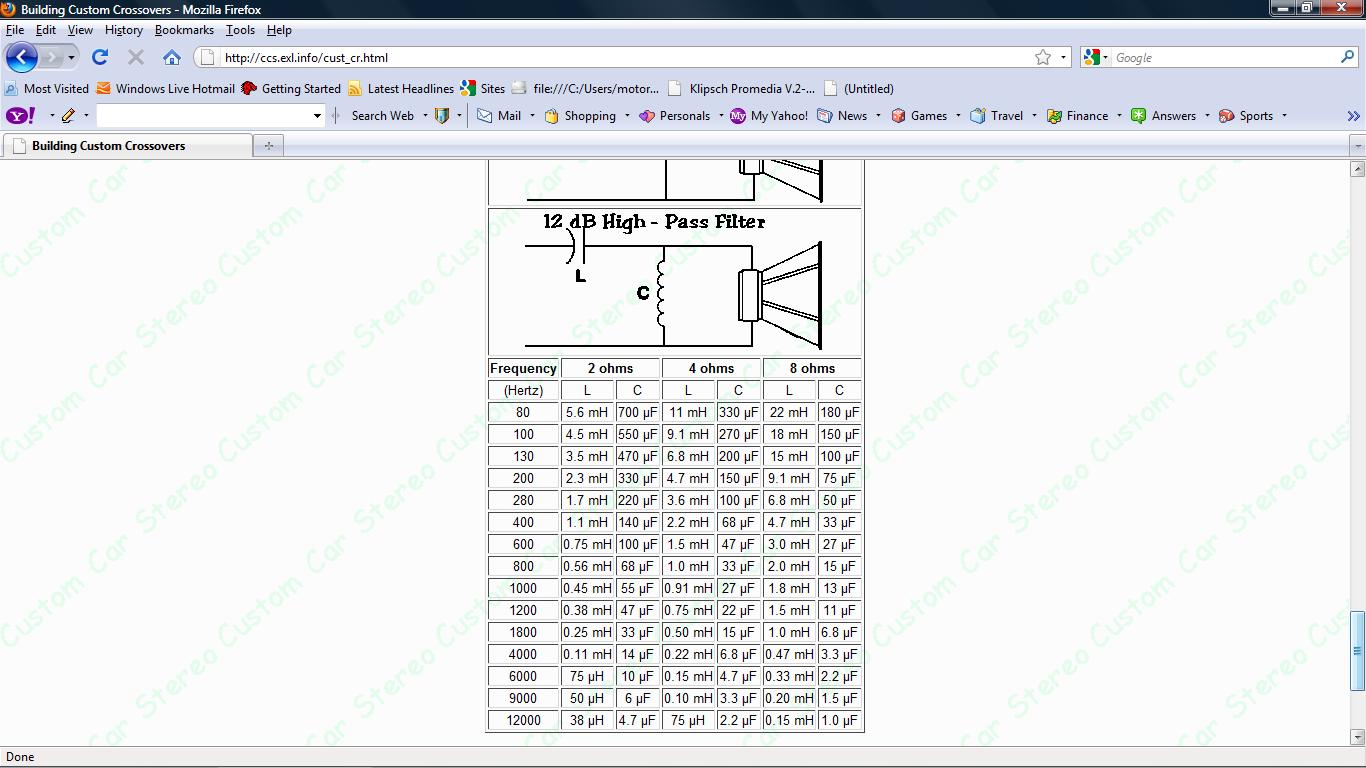

The attached chart is for a 12 decibel per octave crossover. There are many crossover value programs out there if you want to google more but they all pretty much say the same. If you want to go more the 12 then the programs can help you there also. Or just ask if you get confused.

Posted: Wed Sep 22, 2010 3:25 pm    Post subject:
Ha. I was looking at that image I just posted and couldn't figure out what was wrong with it. The letters L and C are in the wrong place but the symbols are correct. The cap goes in series and the inductor goes across the lines.

Posted: Wed Sep 22, 2010 6:38 pm    Post subject:
Forgive my ignorance on this subject but I need 2 pieces? One on the positive side of the wire and 1 between the wires?

Right. For 12 db you would need to use a cap and an inductor. You can also go 18 and 24 db which requires more parts. 12db is fairly common. 6db just uses a cap and is usually used in cheap speakers . The higher the db the more it will attenuate the unwanted frequencies per octave.
