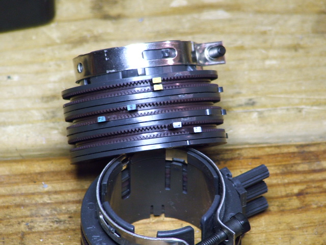

Do yourself a favor and "null" the 2 and 4 pole magnets by overlapping the little tabs (like the yellow ones) before you start. It helps.
Scott
Scott
Great tip! I didn't do this when I first tried to do my tubes. I picked up the same tip from the old Holy Focus thread on AVS. Starting at null really helps to see what differences you are making.

Thanks for the info. So if I get this right Tse... If I line up those posts on the magnets that will null the magnets thereby making no adjustment to the astig. Like a reset to zero? Then I can slowly turn them away from each other to see what effect I'm making?
Thanks! More pieces to the puzzle.
