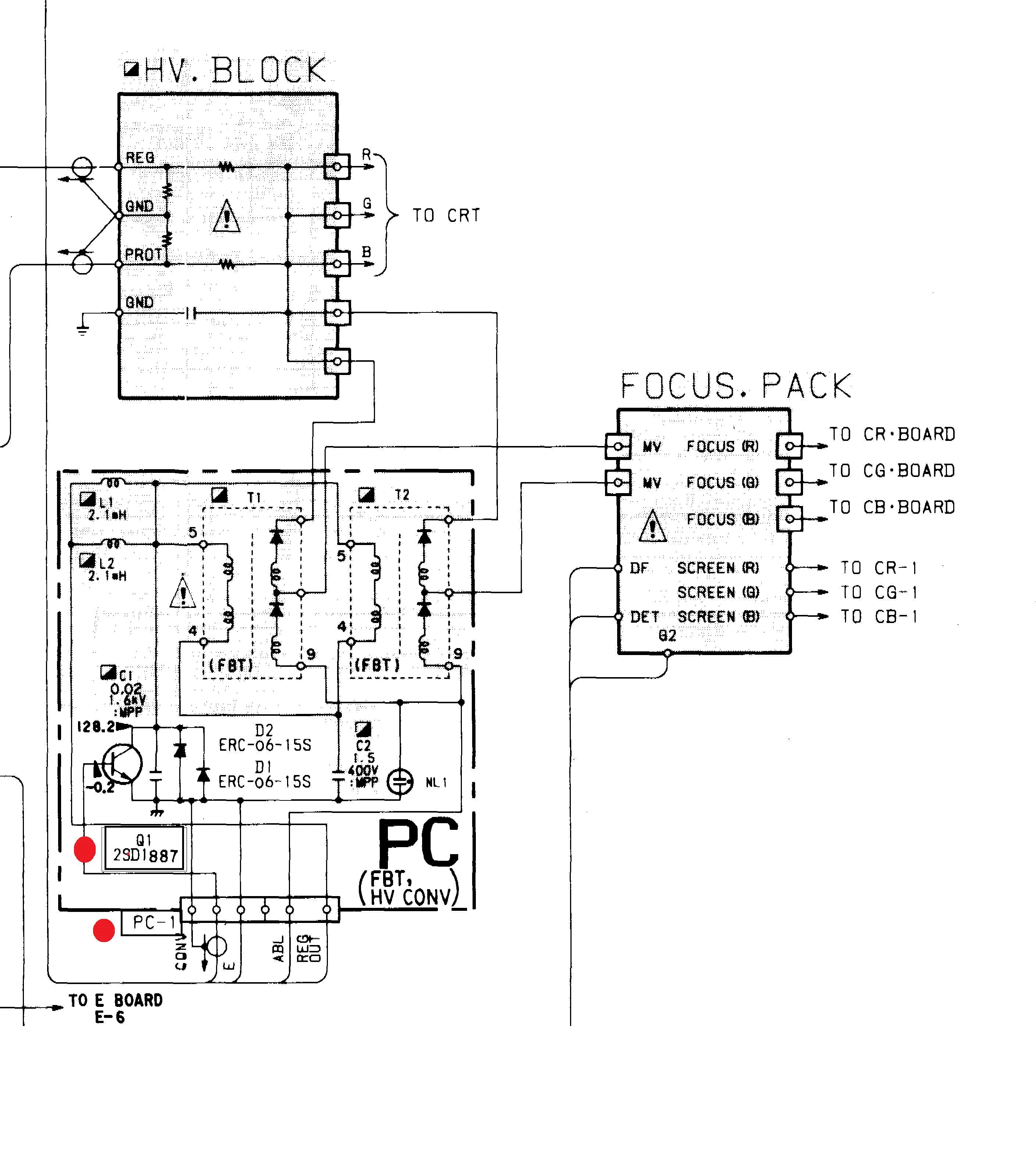

The projector will not turn on, when you remove the PC connector - 1, and reconnecting the projector, electronic works everywhere except high voltage, checked and found that the component Q1 29D1887 burned, I replaced it with a like and burned tabem . Attached schema component.
I came to ask help on forum, I appreciate any assistance.

It's rare, but I've had the HV block short out which then blows Q1.
If you post a picture of the HV block, I can see if I have one. You can have it for $10 plus shipping.

Also, when a component like Q1 fails, it will often take out surrounding components. Even a cap can be blown short. Also diodes.
I would also test REG out to gnd for short.

The HV Block, was replaced by a HV of the Sony 1040, and after not having worked, returned the original.
It is possible to test the HV Block, because a diagnosis is quite likely, as suggested.
HV Block I still have the spare for testing.
Thank you.

I tested the diodes and are normal, removed the board for testing, and capacitors do not have equipment for testing.

With HV problems and no test equipment, you're really down to changing out complete boards and such.

I have a multimeter and test on a friend with an oscilloscope if possible such a test.
When burned the sd1887 Transistor, Transistor BU2527AX Phillips replaces it, but it burned too.
As the drain voltage in the HV Block, fails to start the high-voltage burns sd 1887.

HTdiy- that HV block shown in Case's picture above probably has a short in it. When that transistor has shorted for me in the past, that's always what the problem was.
It is also possible that a tube has shorted, or that the HV splitter has a crack, which is putting an overload on the HV transformer.

And to add to what Curt said, you only need to test those caps for short which you can use your DMM. If those very few components in the diagram are not shorted then you need to check the solder joints on T2 on the PA board. A bad solder connection there will instantly take out that transistor. If you go over everything connected to that transistor and can't find anything then one of the flybacks is probably bad.
The only other freak thing would be is if the +115v supply was way off. But that would be a last guess.

Problem solved with the projector sony, Flaybacr in short, made the switch and replaced the 2sd1887 two diodes and the projector is operating normally.
