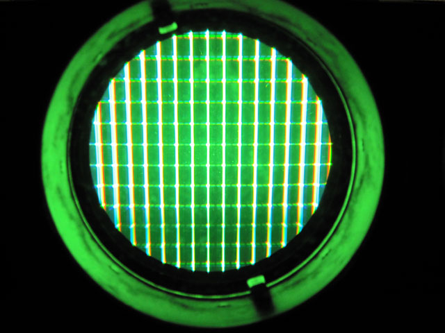

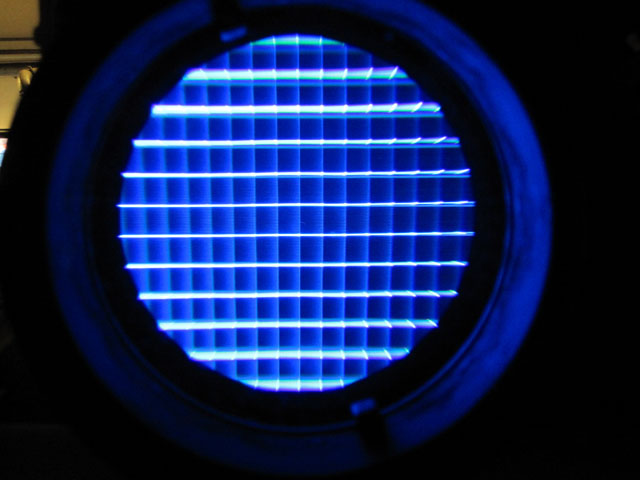

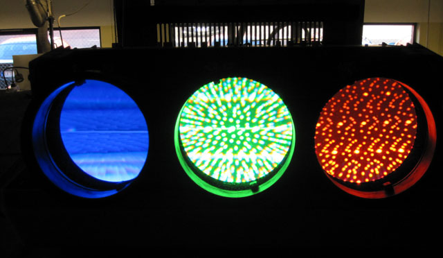

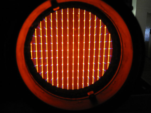

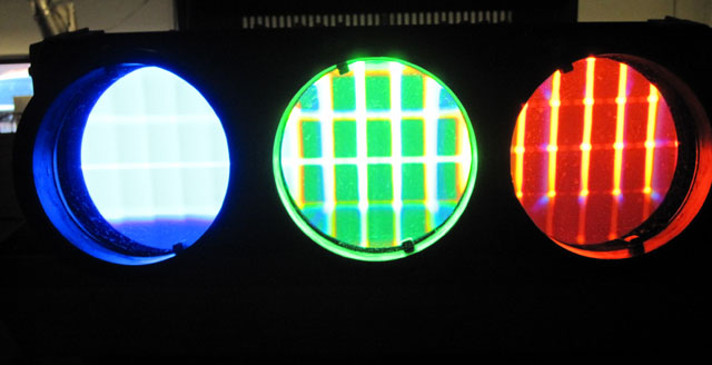

I have some pictures that might held diagnose the problem and guide me. Descriptions in description field.
Blue is strange. Almost seems like horizontal and vertical lines are swapped when comparing to the other tubes
 Filesize:  80.89 KB
 Viewed:  1394 Time(s)
Green 'fine'. Very thin horisontal lines though

Red is 'fine'. Very thin horisontal lines though
 Filesize:  91.46 KB
All tubes. Internal test pattern on. X-tal switch. Autolock pressed.
 Filesize:  68.79 KB
All tubes. Internal test pattern on. X-tal switch. Autolock not pressed.
 Filesize:  86.29 KB
