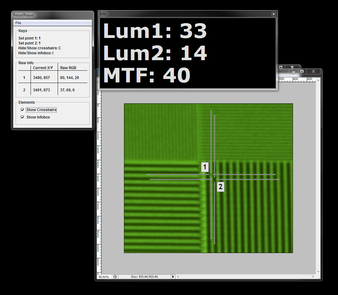

So, I fired up mah Visual Basic and had at it. I now have a nifty app that lets you set two pixel positions and (will soon) tell you the RGB values of each one, plus, probably, the ratio between the two. It'll read anything on the desktop; the trick is that if your webcam display uses an overlay my app can't get the pixel colors. I actually haven't tested mine yet.
But, the nice thing about this method is that it lets you use any optical device to do your work. If you wanted, you could use a DSLR with a macro lens, and write a script to auto-display new images; set your crosshairs anywhere on the desktop and fire away. Not as much realtime feedback as a webcam but potentially better quality.

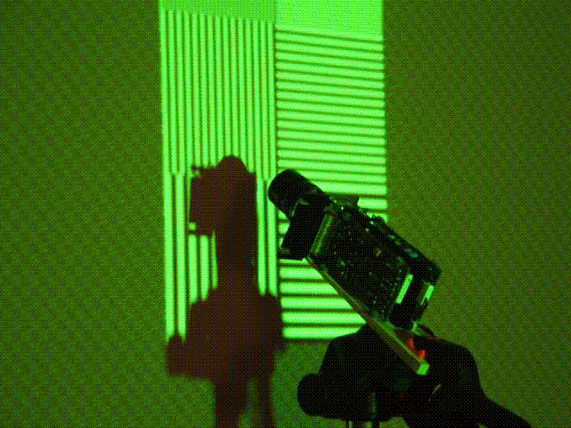

Posted: Fri Sep 03, 2010 11:50 pm    Post subject:
Cool. You can absolutely do this. Your idea of looking at eight points around a spot to determine how round it is sounds great.
To do scheimpflug I think will take four cameras (or a real high res one, like you said). One looks at the top center, one at the left side at the center, yada yada. Focus is easily seen if you project a test pattern of alternating black and white lines. Look at the light profile and compare white level to black level. Best focus is when there is the greatest difference between the two. Adjust the side to side control so left and right patterns "peak" at the same setting. Same with the top and bottom. It is right when you adjust the lens and all four camera displays peak at the same lens setting.
Maybe five cameras with one in the center. Adjust center focus barrel for best center focus then the outside barrel for the best outside focus.
Get the cameras up close to the screen so they are looking at a small area. Put a lens spacer between lens and cam so it can focus up close.
It helps alot to have full horizontal size and full vertical size projected when you do this.
Go for it. This would be a great tool.

Posted: Sat Sep 04, 2010 12:40 am    Post subject:
OK, here we go:
Current features:
    • Catchy name
    • Always-on-top crosshairs; you can move the image or use GUI elements in the webcam without losing your place
    • Crosshair visibility selectable
    • Huge-ass MTF readout that assumes you'll be showing Focus!Focus! on your projector and it'll get fuzzy when you change the focus
    • Set test points with keyboard so the window doesn't switch as soon as you click
    • '1' and '2' labels automatically swap to the position furthest away from each other so they don't obscure the selected pixel
Obvious to-do:
    • Complex, overwrought splash screen
    • Installer with onerous but probably unenforceable EULA
    • Zoom window with internal crosshairs so you can see where the hell your cursor is
    • Calculate MTF based on more than one pixel selectably
    • Test on an actual webcam screen instead of a screenshot from somewhere on CurtPalme/forum
Not-so-obvious to-do:
    • Auto-seek high or low luma pixels near the clicked area to avoid holding down the select key and dragging around until you see the highest/lowest luma value
    • Use temporal averaging on selected pixel to avoid crazy-changing MTFs with flickering output
    • Selectably-huge-ass MTF readout for different scenarios
...and then there's the Far More Complex stuff like astig support, internal support of webcams, etc...
Anyway, it's a start. If I can determine that it'll actually work on a real webcam, I'll prolly package it up and let you guys play with it.
