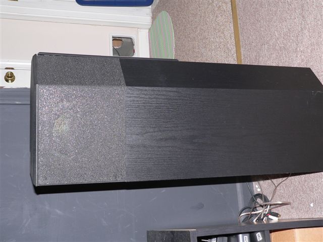

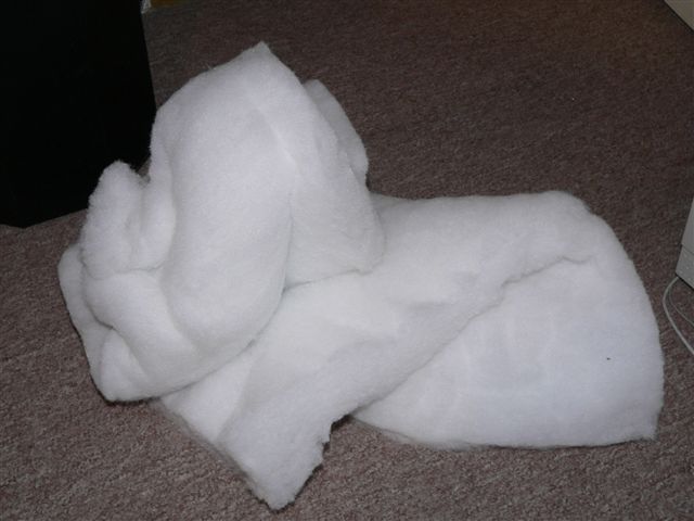

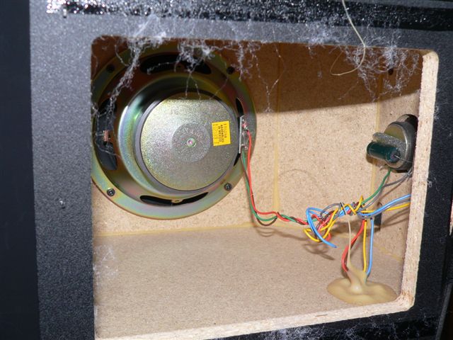

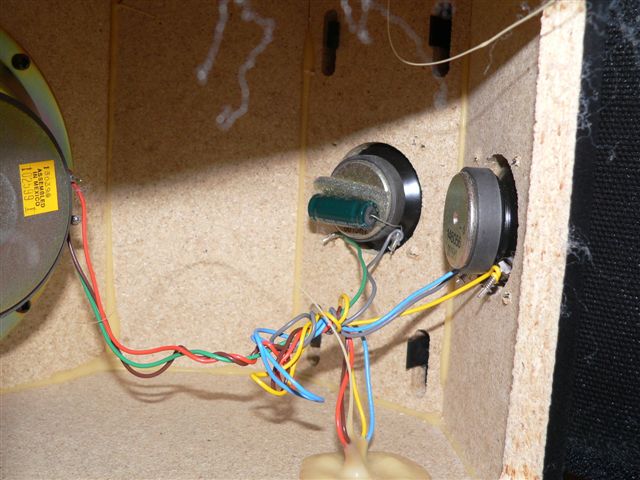

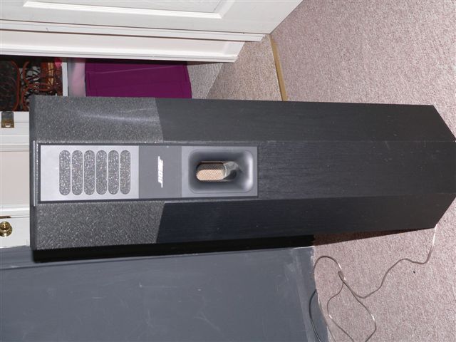

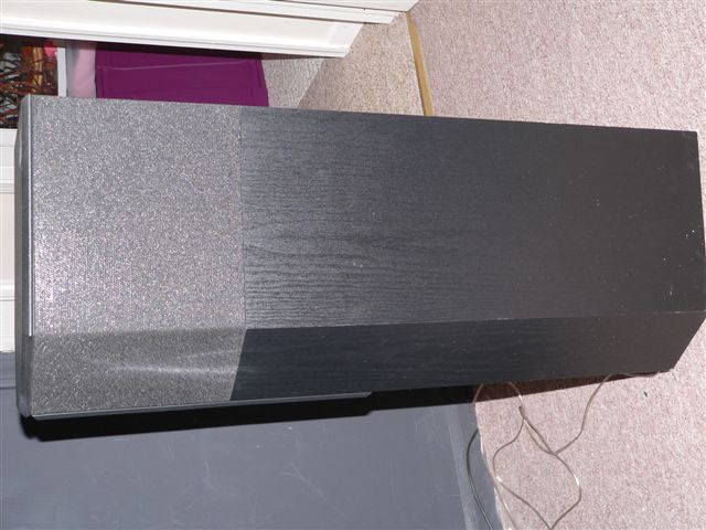

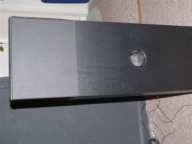

Answers to questions. . .
1. Yes, that is dust in the ports.
2. No, those aren't cob webs. The upper compartment was stuffed with foam.
3. White streaks on grill are from a white crayon in the hands of a 3 year old. Any ideas?
Damndest cabinet design I've ever seen. there are 2 8 inch drivers facing each other wired out of polarity to do a push-pull thing. I just can't see HTF you could ever get to them to replace them.
