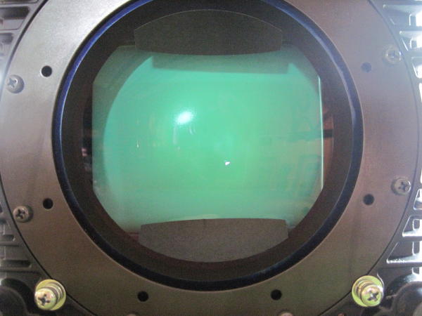

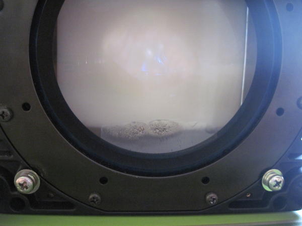

Posted: Sun Sep 05, 2010 7:43 pm    Post subject: calling all C element experts
Have a look at this: green and red C elements are fine. The black tape on the blue C element was bubbled up. I tried to smooth it out but it would not stick. When I removed the tape this what it looked like. should I get a new one or put new tape over it.
Thanks,
Dan

Posted: Sun Sep 05, 2010 9:31 pm    Post subject:
Das444 wrote:
Anyone know why there is black tape at the top and bottom of the C-elements? The blue coolant chamber was emptied.
Should I rinse it out with water? I don't want the coolant to dry up in the chamber.
Thanks,
Dan
good question, looks too uniform to be a DIY job, maybe something done specifically for rear projection?
Glycol doesn't really dry out, it's almost like an oil.
Ile
Posts: 1491
Location: Jyväskylä, Finland
Posted: Mon Sep 06, 2010 7:34 am    Post subject:
All LC NEC's have those tapes there for masking purposes, so that stuff is just glue residue. Put some masking over it, or it could cause same reflection from glue residue.
I have planned similar masking to my BG808s LC, there is some ABL glow at top of tubes.
