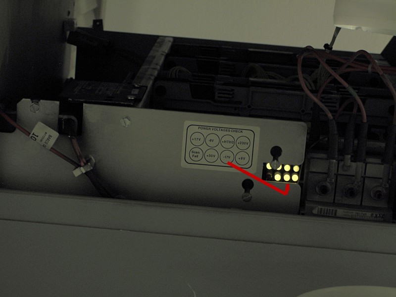

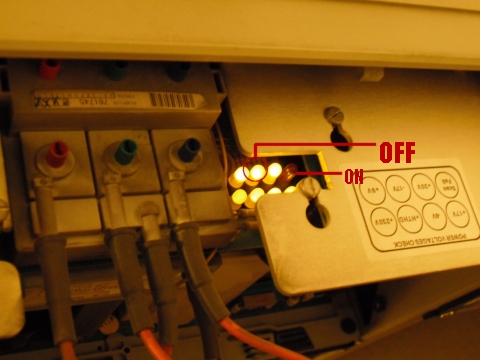

Occassionally my Barco 500 Data will switch off the guns (black screen) and give no 2nd YELLOW LED and a RED LED highlighting a fault.

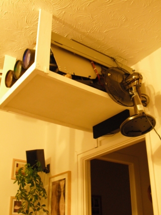

My only fix to date is to turn off the unit and cool it down with a fan as I've come to think it's overheating.
It happened today so as a process of elimination I've temporarily mounted a fan to blast the heat away from the motherboards and it seems to be doing the job.
Unfortunately I don't have a legend to explain what each LED represents.
If it *is* overheating I'll invest in making a cooling system to pull air through the roof via air ducts.

Posted: Fri Dec 10, 2010 2:23 am    Post subject:
Can anyone recommend a specialist or service/repair engineer in the UK that deals with Barco CRTs.
I still seem to be having this scan fail fault on -17v.
Shipping to Mr Palme USA is a bit impractical.
The projector is obviously trying to tell me that something is wrong. I've tried looking at the schematics and it seems to point to the power supply.
