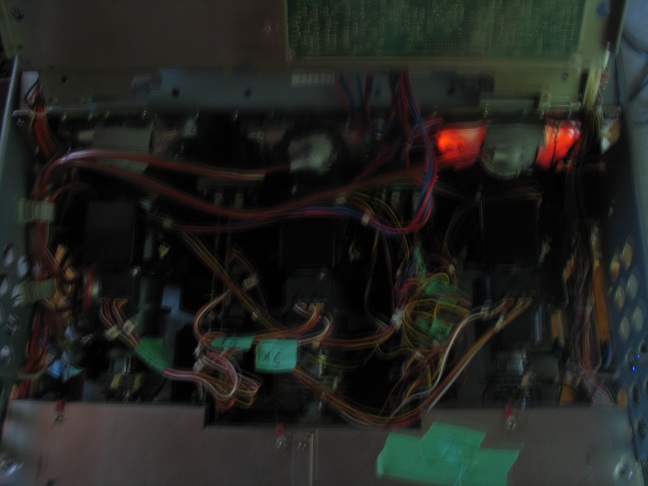

All of that being said - I just noticed this now (can't figure out how I missed it) but the tube bell is illuminated red (see attached). I've never seen this before on any other set I've owned - is this normal?? Still wrestling with focus..
EDIT: Just realized I'm a super idiot - all 3 tubes do this... only had the red tube on when I took the picture... don't tell anyone Razz
